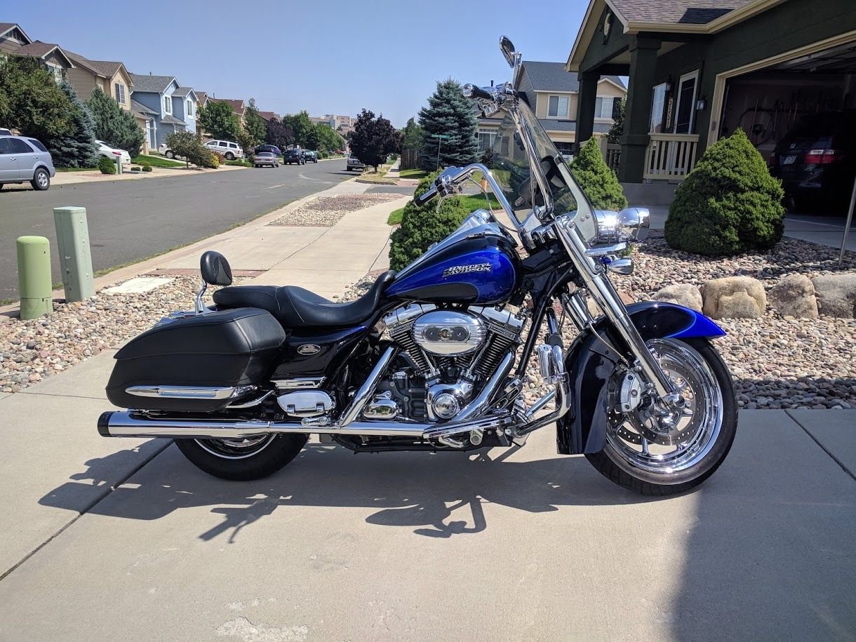

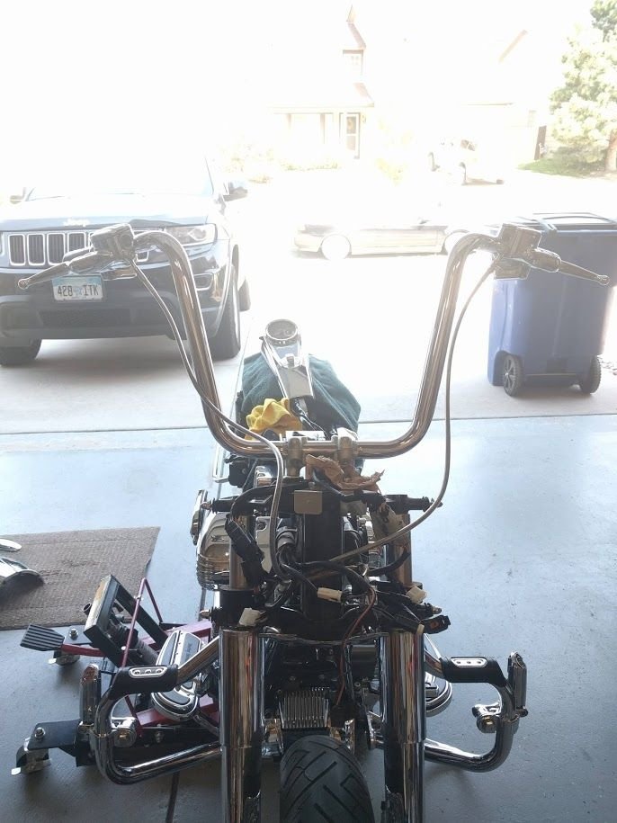

Stel 67, we have the same bike! Thanks for the photos, I see how mine will look with the new bars.
