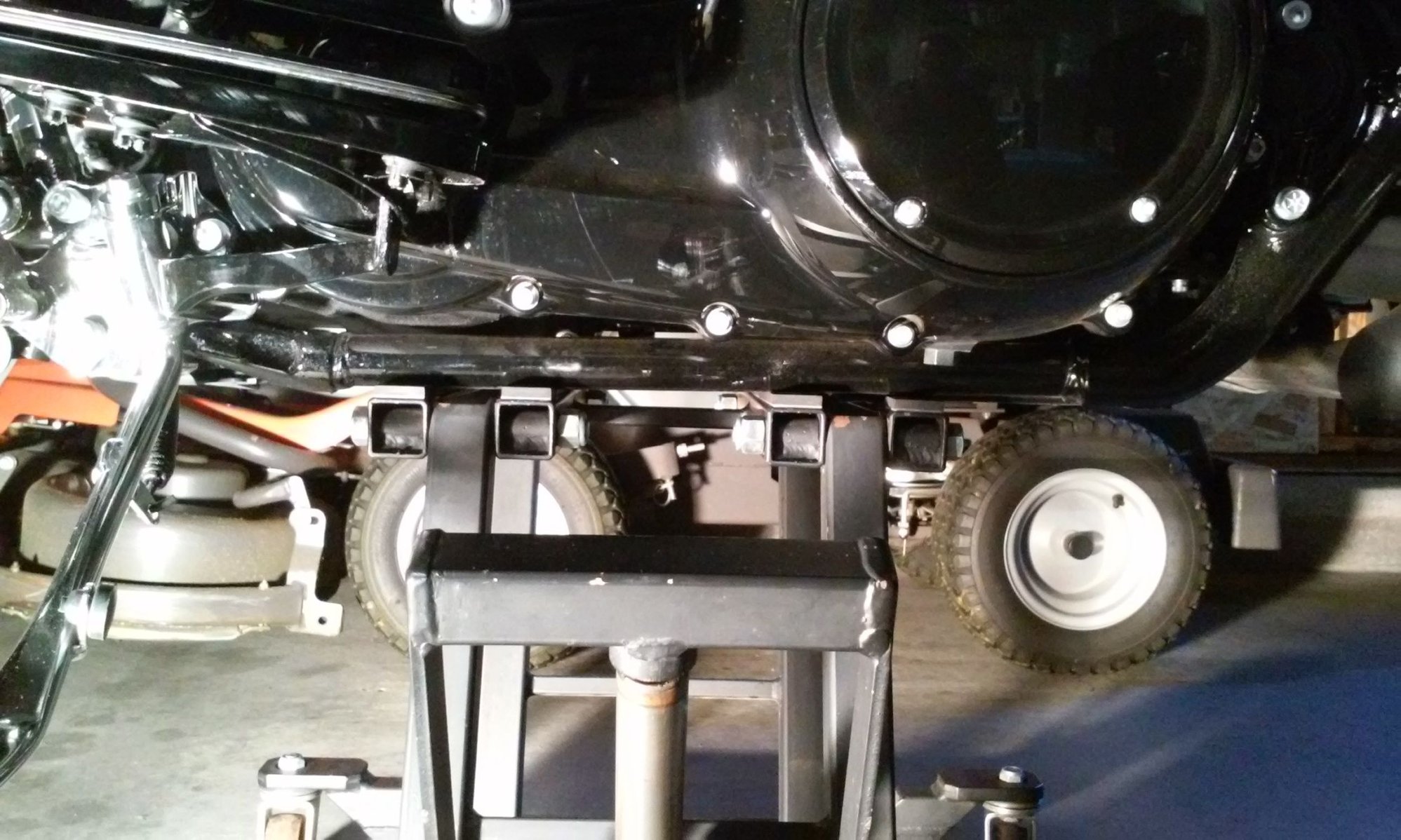

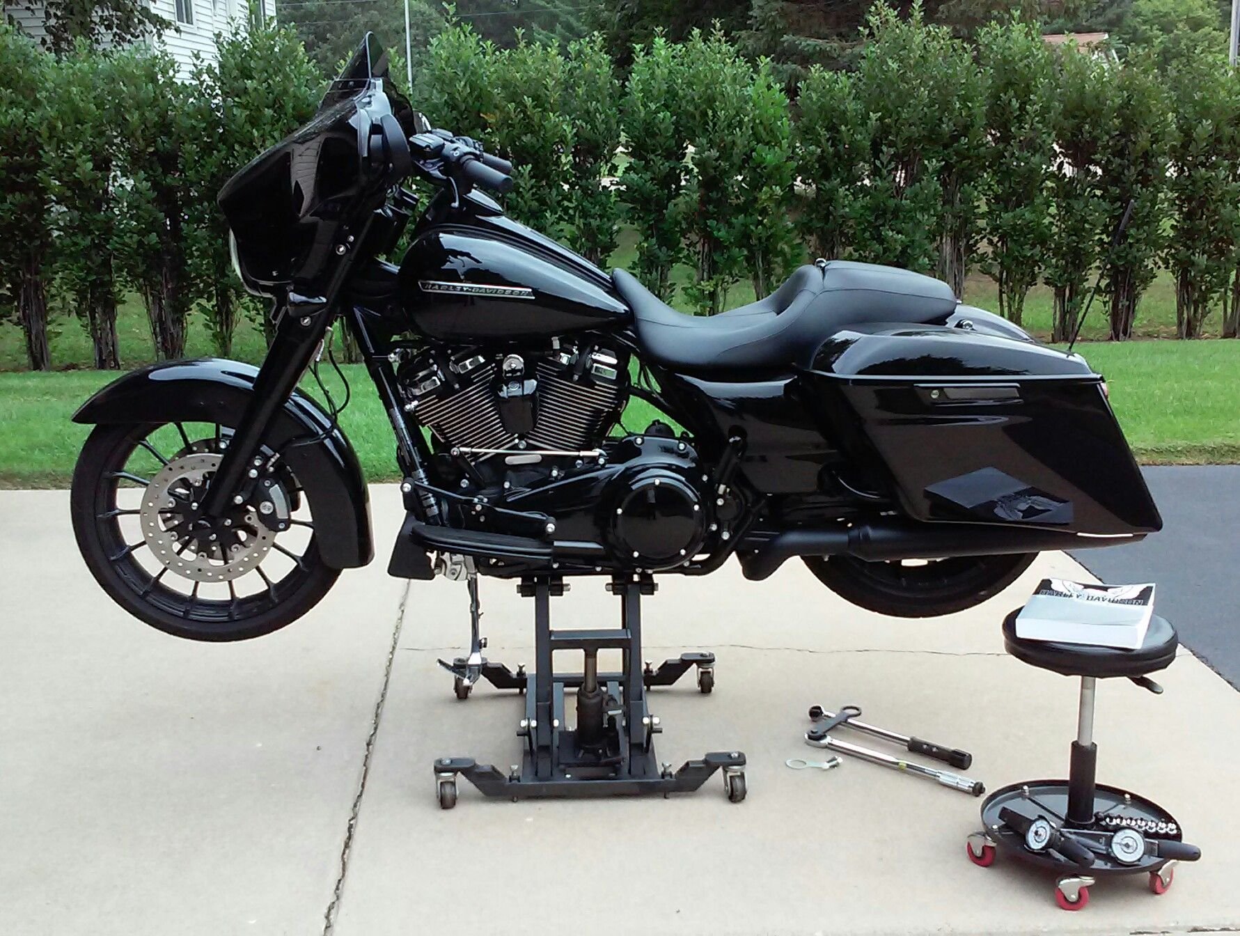

Originally Posted by BobRR
For all the naysayers, you should look under your bike. You may find that on the M8's the bottom of the engine/oil pan hangs BELOW the bottom of the frame rails. In that case you HAVE to use frame protectors. (They should probably be called "Engine Protectors" for Road Kings and "Shock Protectors" for Softails)
Here is a quote from the Harley "Frame Protectors" product page...
"A must for softail models to provide the clearance necessary to keep lift pressure on the frame and not the shock absorbers"
https://www.harley-davidson.com/store/frame-protectors
Strange, your Road King, and my Street Glide Special share the same frame/engine. My engine (at it's lowest point) does not hang below the frame rails. Yes, it's close, but the jack does not contact the engine/oil pan.

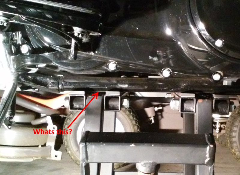

What is the arrow pointing to?
Old Feb 27, 2019 | 08:59 AM
Cygnusx51's Avatar
Cygnusx51
Joined: Oct 2011
Posts: 5,691
Likes: 1,651
From: Olean, NY
Looks like the gap between the frame rail and the jack, between the lift arms. You can see light passing through. It’s the same on the back.
