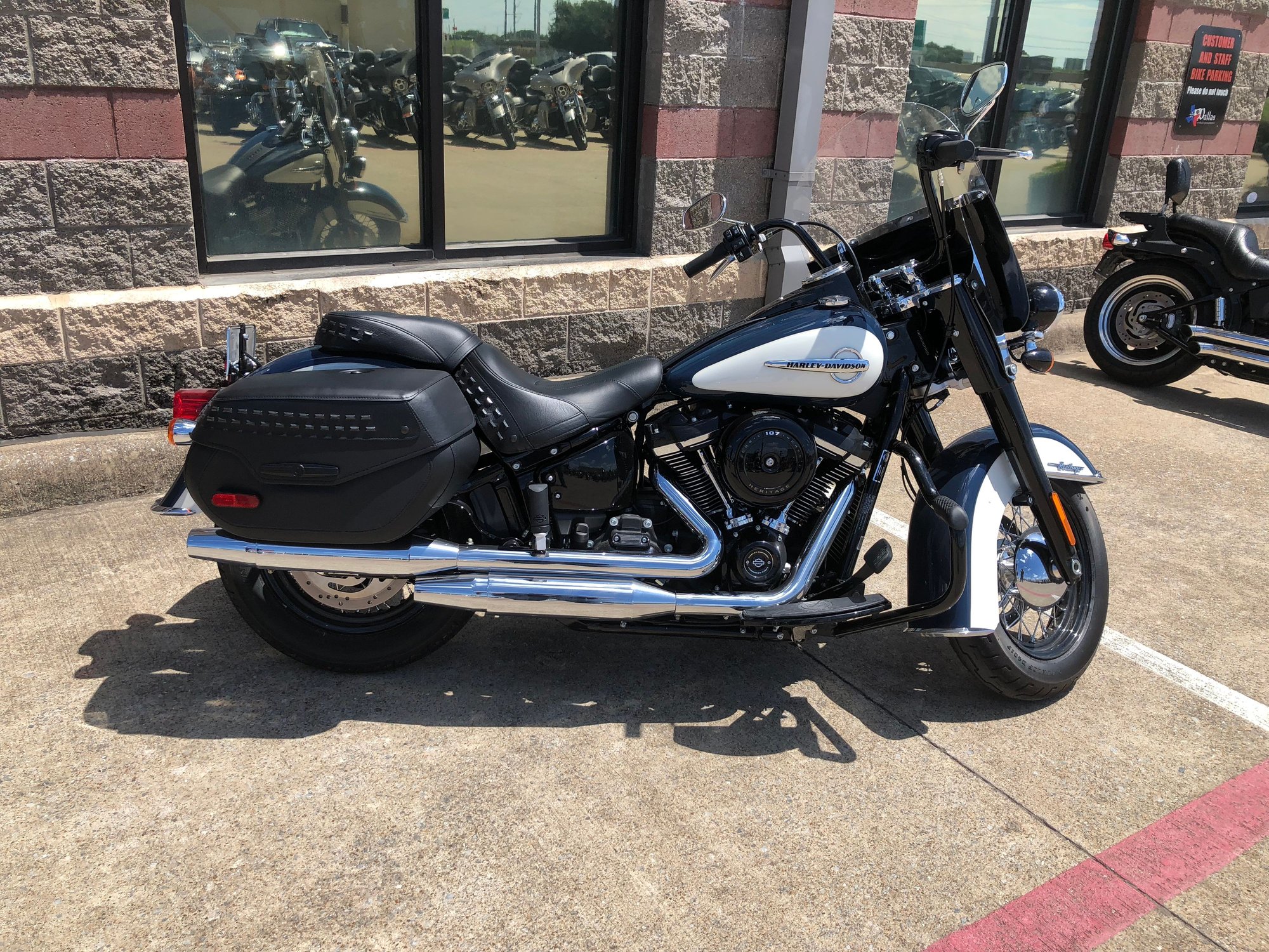

Not sure. Can you tell from the photo? I just bought it new about 10 days ago.

Doesn't look like you have mid-frame heat shields.
HD sells them but Captain Itch sells nice shields too that are more protective than Harley's. FWIW...

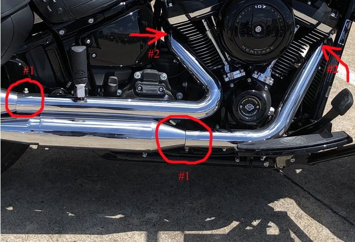

I disagree. Seems clear to me that he does have heat shields. I have taken the liberty of copying and editing in what leads me to that conclusion:
The circles (#1) show where I think the heat shields terminate on each pipe. The arrows (#2) show where the OP can look and where he should see the header underneath the heat shield. Even with low miles, there's probably some discoloration (blue or gold-ish or both) under those places on the pipe. Looks like there might be heat shields on the mufflers too, but not sure about that. You can see where the adjustment screw is for the hose-clamp that holds the shield on @ the #1 marker near the center/bottom of the pic. I'm about 99% sure there are heat shields on that bike.

My bad, I meant heat deflector.
Yes, there are heat shields on the exhaust, which most bikes do have.
