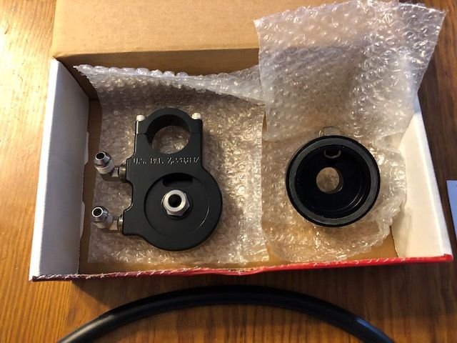

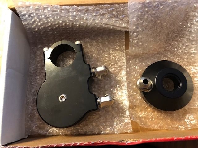

As you can see in the following pictures are the main components of the kit. The first picture is the center screw assembly which holds the adapter face to the engine. It has a VITON o ring installed on it. With the center screw are two Parker connectors. Why two loose connectors? 3guys only ships you one hose with two connectors already installed on it. You will take and cut this hose to custom fit your installation. Smart!
Did you notice the black cup washers on the Parker connectors? That is a nice finishing touch. It finishes the installation of the hose onto the connector. Just remember to cut the hose square to the hose during assembly!
Finish is first class as well as the machining on the adapter center bolt. Nice! Another Plus to 3guys.
To the left is the relocation mount that attaches to the frame. To the right is the adapter plate that mates to the location where the filter mates on your engine. You notice the connectors are preinstalled on the plate and relocation mount. Nice touch, leaves one less thing that can be screwed up. The parts appear to be machined. They are of very high quality machining. No unusual marks or chips, dents etc. The finish is first class too. Plus
(The writing on the mount is the patent # for the design.)
The stainless steel set screw is for an optional oil pressure gauge that I did not order. This mount will be low on the frame and to be honest, I will not be looking down to see my oil pressure. We riders have enough issues with keeping the cages from killing us on the road!
The hose is Parker brand as well. It is rated at 250 PSI. Appears to be hydraulic hose (thick wall). Appears to be super strong and will last the life of the mount. Another Plus to 3guys on thinking through the design.
I wanted to wrap up part one by describing the contents and quality of the installation guide. It is seven sheets filled with color pictures and easy to follow step by step "do this", then this, then this......with plenty of "awl ****" warnings to keep you on your toes. There are plenty of color pictures with clear details showing you what to do. It even has a parts list of all the parts in the kit for your reference. Since I have not installed the kit yet, I cannot comment on the accuracy of the directions. Reading through them, the directions seem to be complete and nothing that I read seems to contradict itself. After I install the kit, I will follow up with any post installation comments.

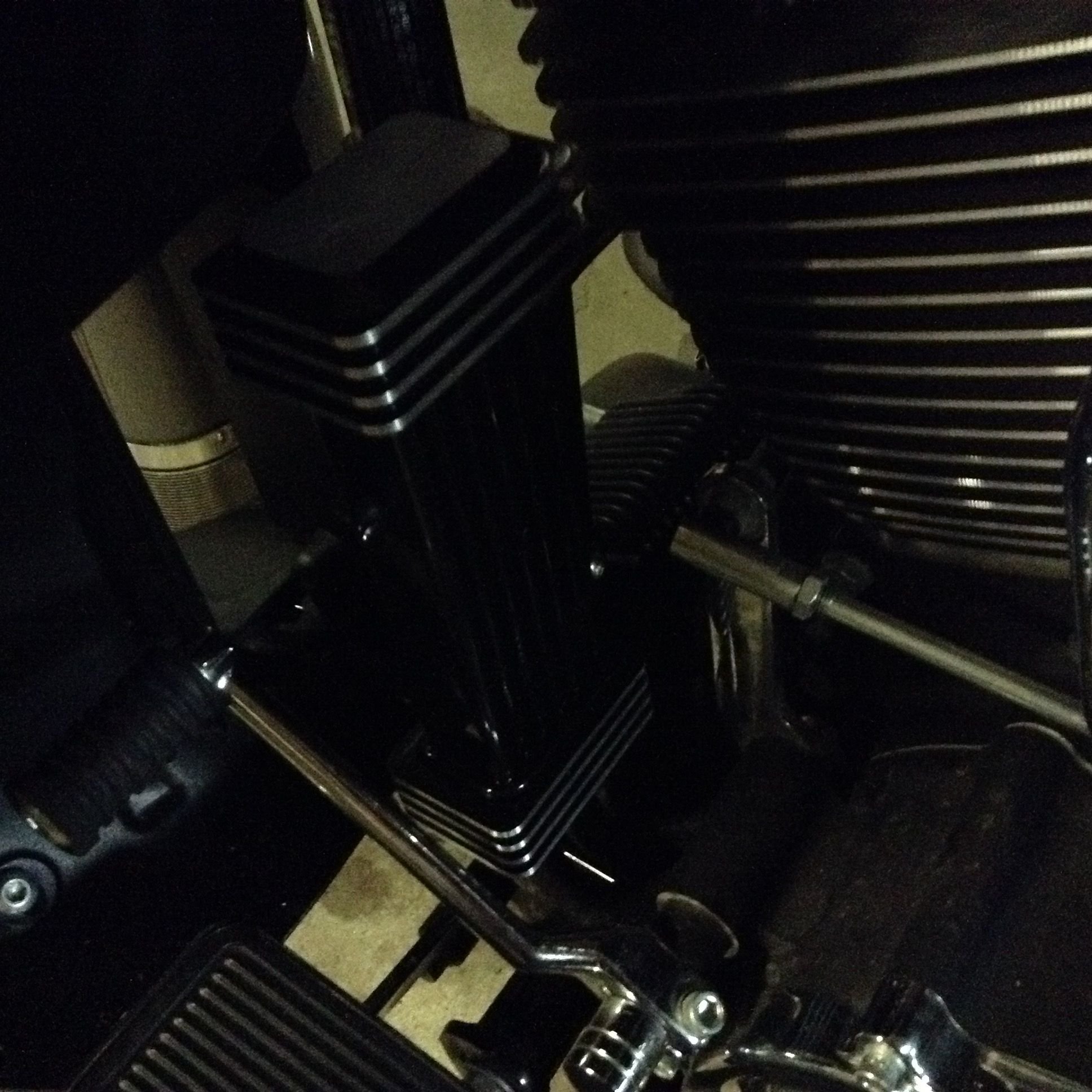

Originally Posted by Qdog002
Doesn`t DK Customs have a version of this?
...yep, put one of their kits on my trike last year.
