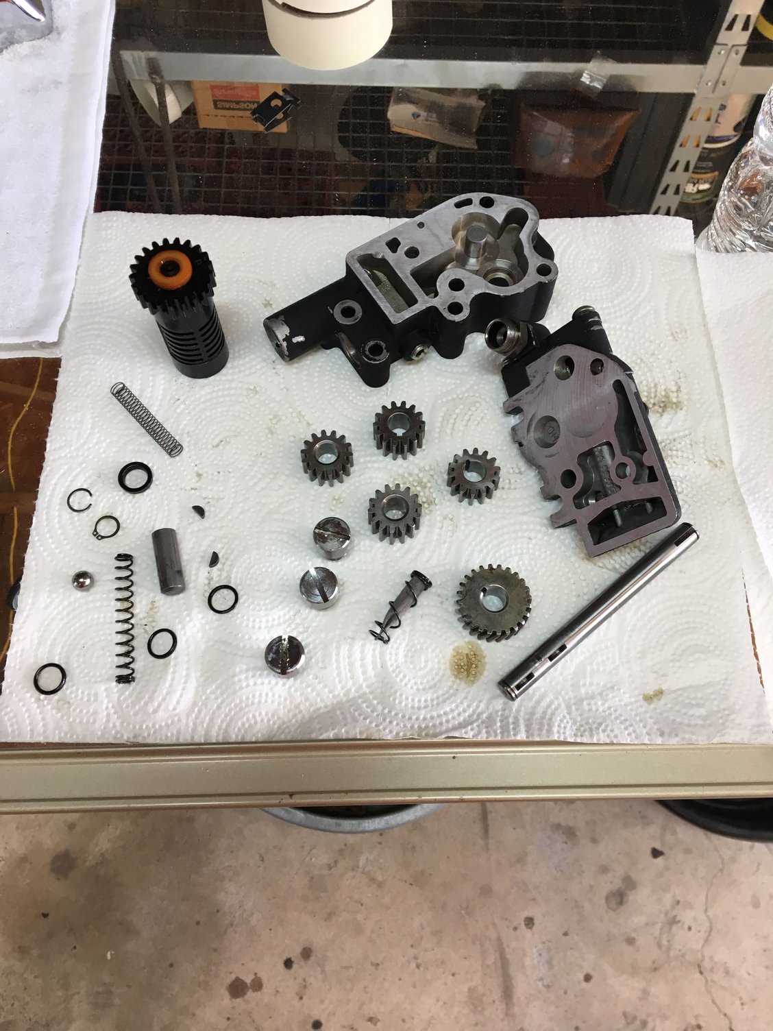

When I installed my rebuilt oil pump last night, the top outer screw wouldn't grab. There's no room to drill out and helicoil. Is tapping out the 1/4 x 20 to a slightly larger metric screw a solution or ?

The hole has stripped internal threads. Being aluminum it's possible the PO didn't use a torgue wrench and just cranked down, stripped it and then inserted a cheap fix. I was finger tightening the bolts using only an allen socket and it just kept turning.
