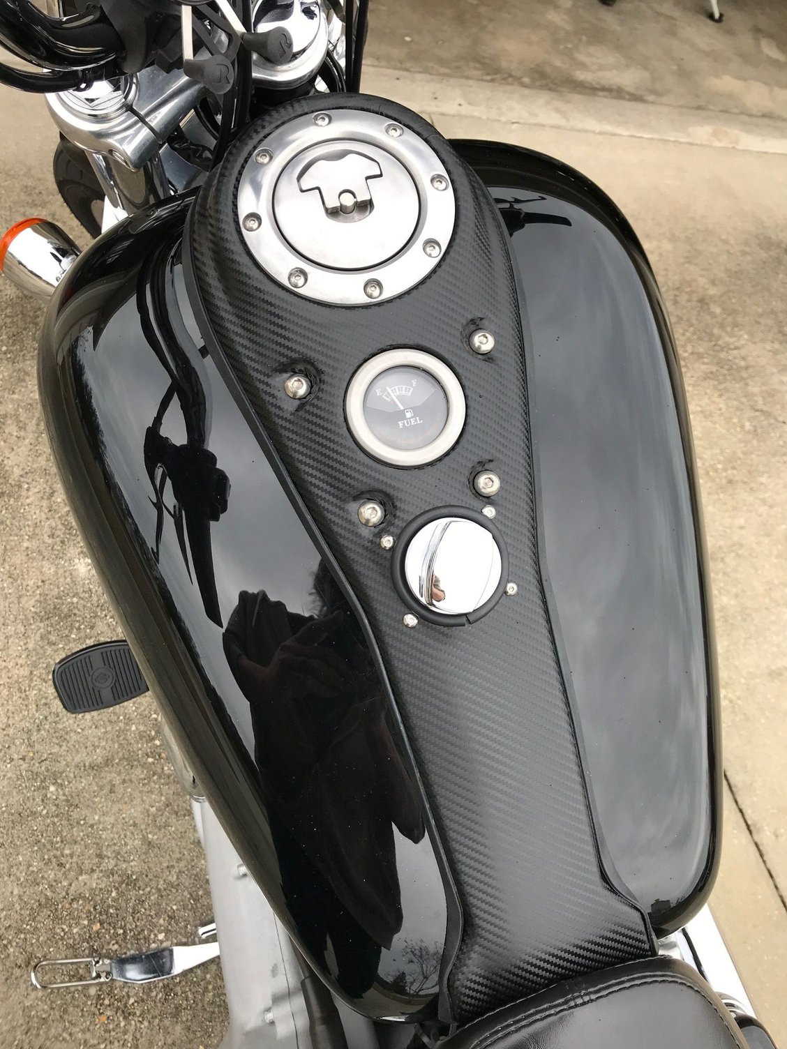

Originally Posted by Benson Liam Serr
How extensive of a job was it to relocate it to the tank?
It wasn't too bad a job. Here's a couple of links from the Dyna page to guide you along...
https://www.hdforums.com/forum/dyna-...elocation.html
https://www.hdforums.com/forum/dyna-...e-up-pics.html
Ended up like this...

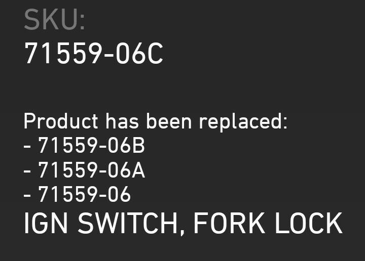

The original 06 ignition switch has been superseded 3 times. In most cases, that means there were problems with the first 3 versions.
