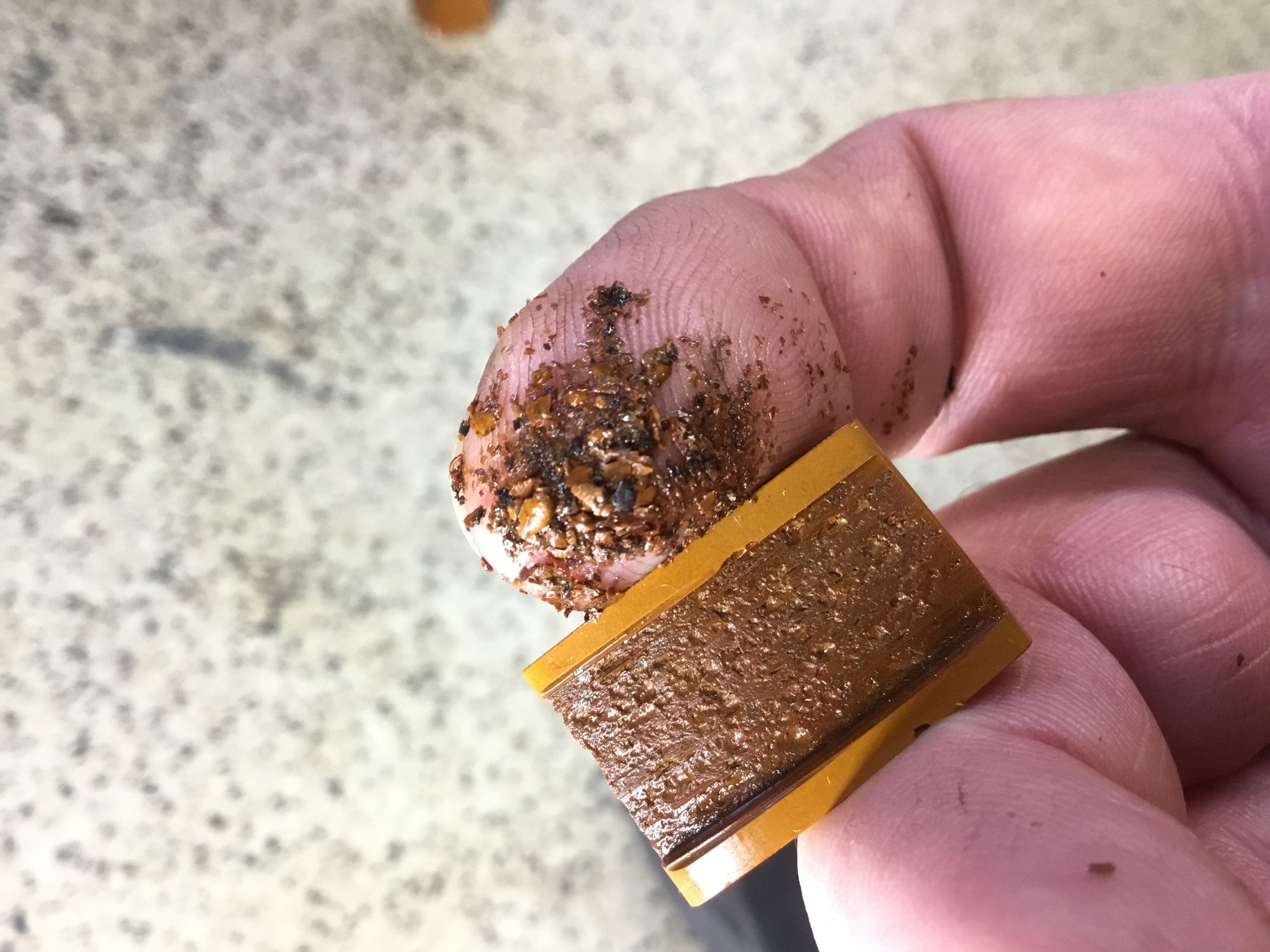

lf you remember in my first post , I said I was opening it up to replace the nylon cam tensioner shoes . And I also said that the seats inside of the lifters had gunk built up on them . Well it was in all of them . So where do you think all the very small pieces of the nylon are going to as they wear off the tensioner shoes ! That just happens to be with in inches of lifters .
With the above said, I would Recommend that when you do the cam tensioner shoes , spring loaded or hydraulic to disassemble and clean your lifters . I was very surprise to fine that **** in there building up like a Clogged artery going to your heart .

For the last follow up on this . All four lifters have held the oil in the top of the cups for over 24 hours now .

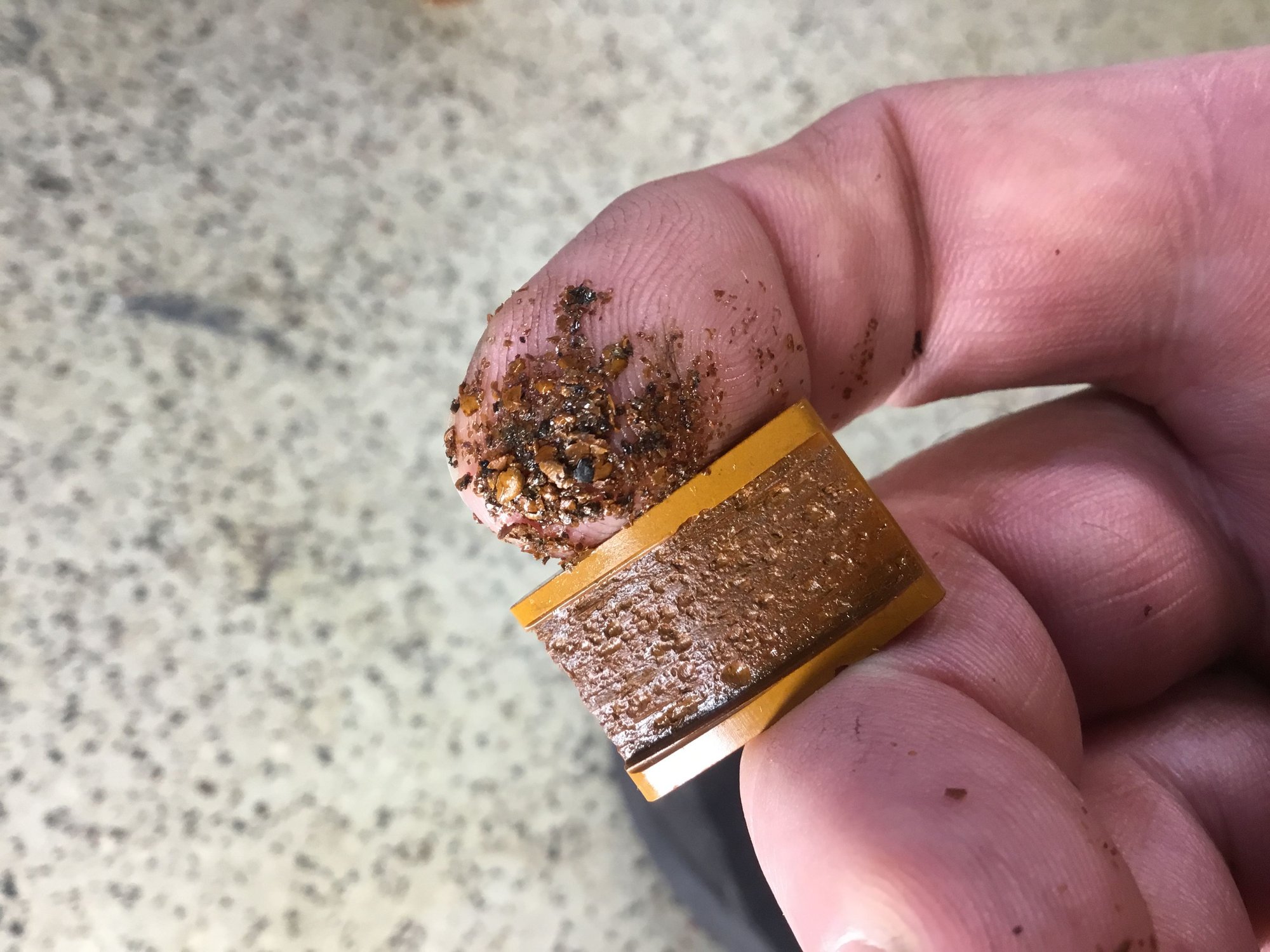

Here’s some pictures from the small Stainless oil bag that catches the larger debris . The fines in the lifters were the same color. So cleaning the lifers when
doing the chain tensioners is just good maintenance that can’t hurt . Remember this is only done once every 35,000 miles .

Iron..add a signature line on your year, model and letters of your bike. Now you got me wóndering just how stopped up the screen is in my cam plate for my balance shaft oiler and tensioner. I checked mine years ago at 25K. Had intended to replace them next time just due to age. Now I have 50 K on them. Retired and am never around till summer and then I ride it..ha. Managed to get a whole 168 miles on it.
What SS oil bag are you referring to?
