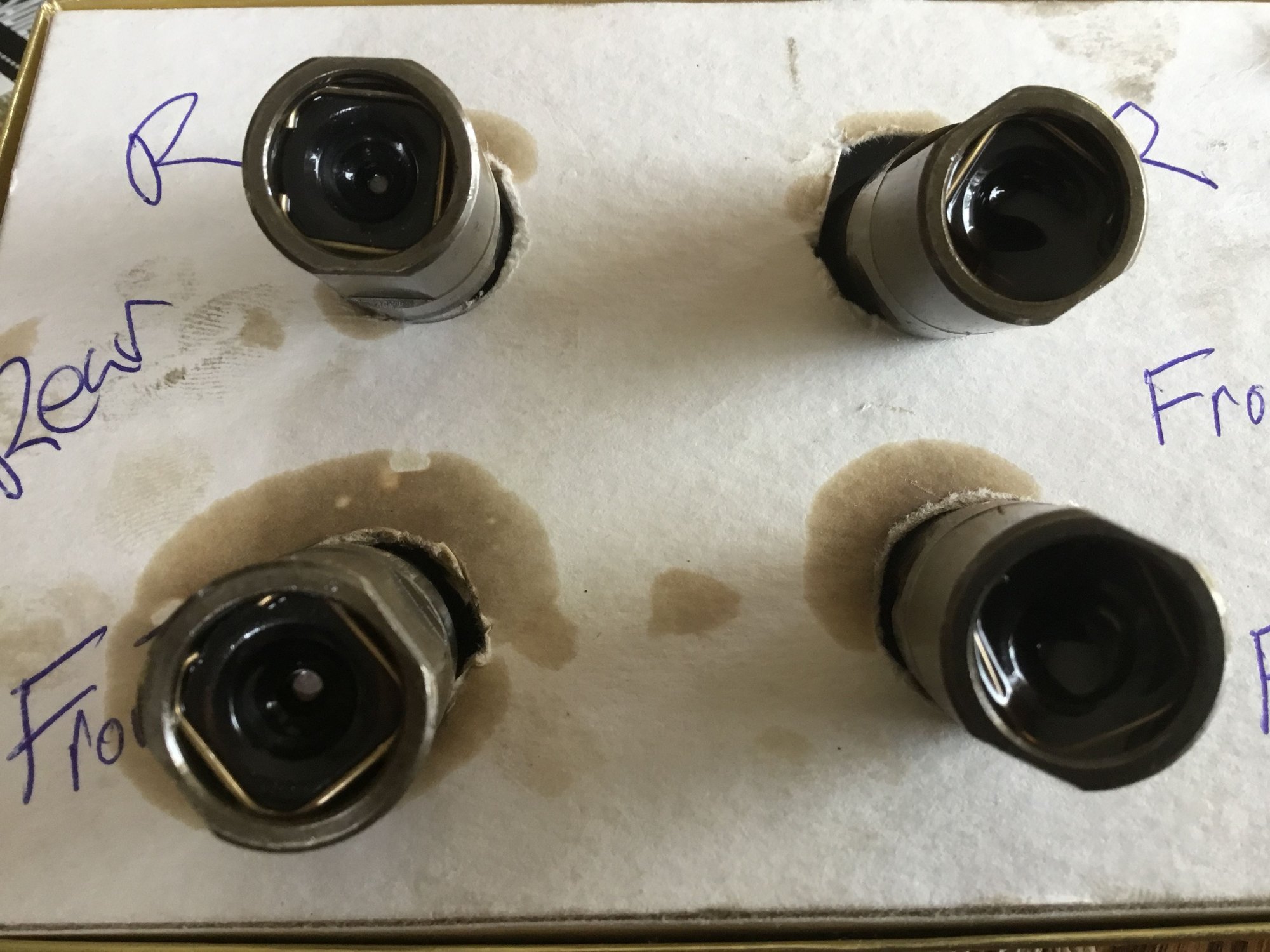

I removed the lifters and placed them in a box facing up . Then filled the upper cups with oil and two of them will drain down . One in about 3 minutes and the other in about 6 hours . So is this normal or a bad thing ? Should I disassembled them and clean them to get them to seat ?
I can’t compress any of them with a pushrod and they where not giving me problems or making any noise when in the bike . I just remove them to do the cam tensioner shoes . There’s 35,000 miles on them now . And the service manual has no replacement interval for them . So how do you guys determine when or if they should be replaced ?

That is not how they work. You just happened to get them in a little different stage of pressure. There is a check with a load that compresses the pumped up piston. It falls in say 1 minute. (Just an example). That way it is not worn to the point that it would collapse during valve opening cycle. I would not worry about them if they were fine. But I have pulled my Jeep ones apart and cleaned and inspected them. No problems. Just make sure it is in exactly correct order, that retainer did not get bent and is properly in groove. YouTube is your friend here.

100% correct. In addition, if the rollers have no signs of pitting or grooving that you can catch a fingernail on, run 'em.

As an added info, it takes pressure in the range of the valve spring to actually bleed it down. If they didn't work like that, they could pump up and hold valve open. They stay pumped up to the base circle of the the cam so there is no tap when they hit cam lobe to open valve.
They probably bleed off a few .001 during cycle but catch back up before the next opening. My guess anyway or it would be no advantage of solid lifters in a full race engine that wanted ever HP.

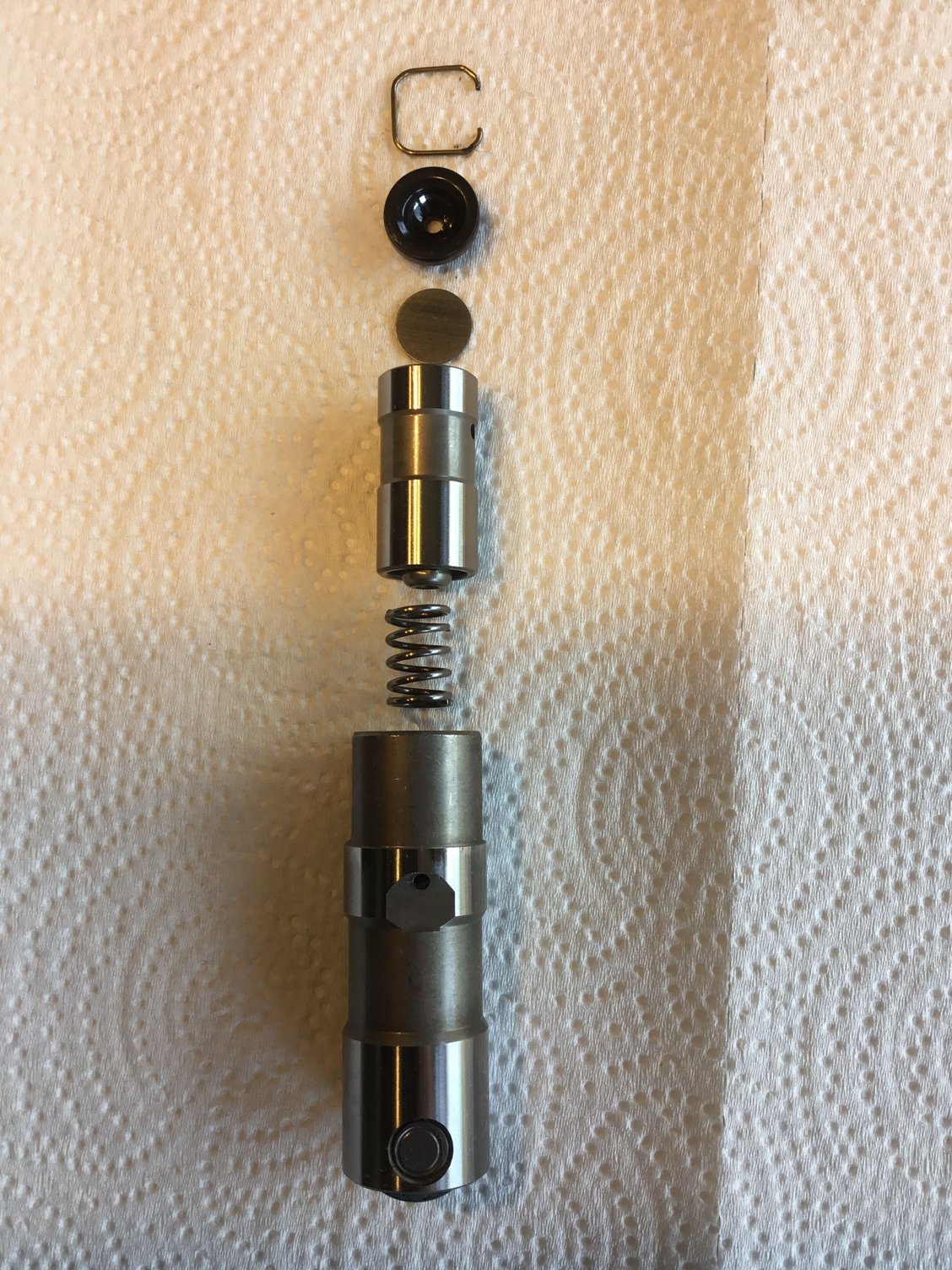

Ok , so I wiped off the one that was draining down in 3 mins . And when I blow air into the top with my mouth the oil comes out the hole on the side of the lifter body . Because of this , I decided to disassemble and clean internal parts . What I saw was the very small hole for the ball check had a lot of hard gunk built up in the hole and at the bottom of the body where the large spring seats also had a good amount of firm gunk too .

So after cleaning it and trying to put it back together I determined that the ball check was not seating well . Here why , when I went to disassemble it and remove the inner body that holds the small spring and ball check . It came out with no effort, it almost fell out on it’s own . If the ball was seat was properly seated the vacuum would not let you pull the inner body out .
I found this out because, I fill the lifter to the top of the large spring before putting the inner body back in . This was to much oil so I push in on the ball to remove some if the oil, to get the inner body to seat at the bottom of the main lifter body . When the ball check is working properly it is very hard to put this thing together with the oil in it. Little Learning curve there . The next three should be cake . And I do think this fix it .
