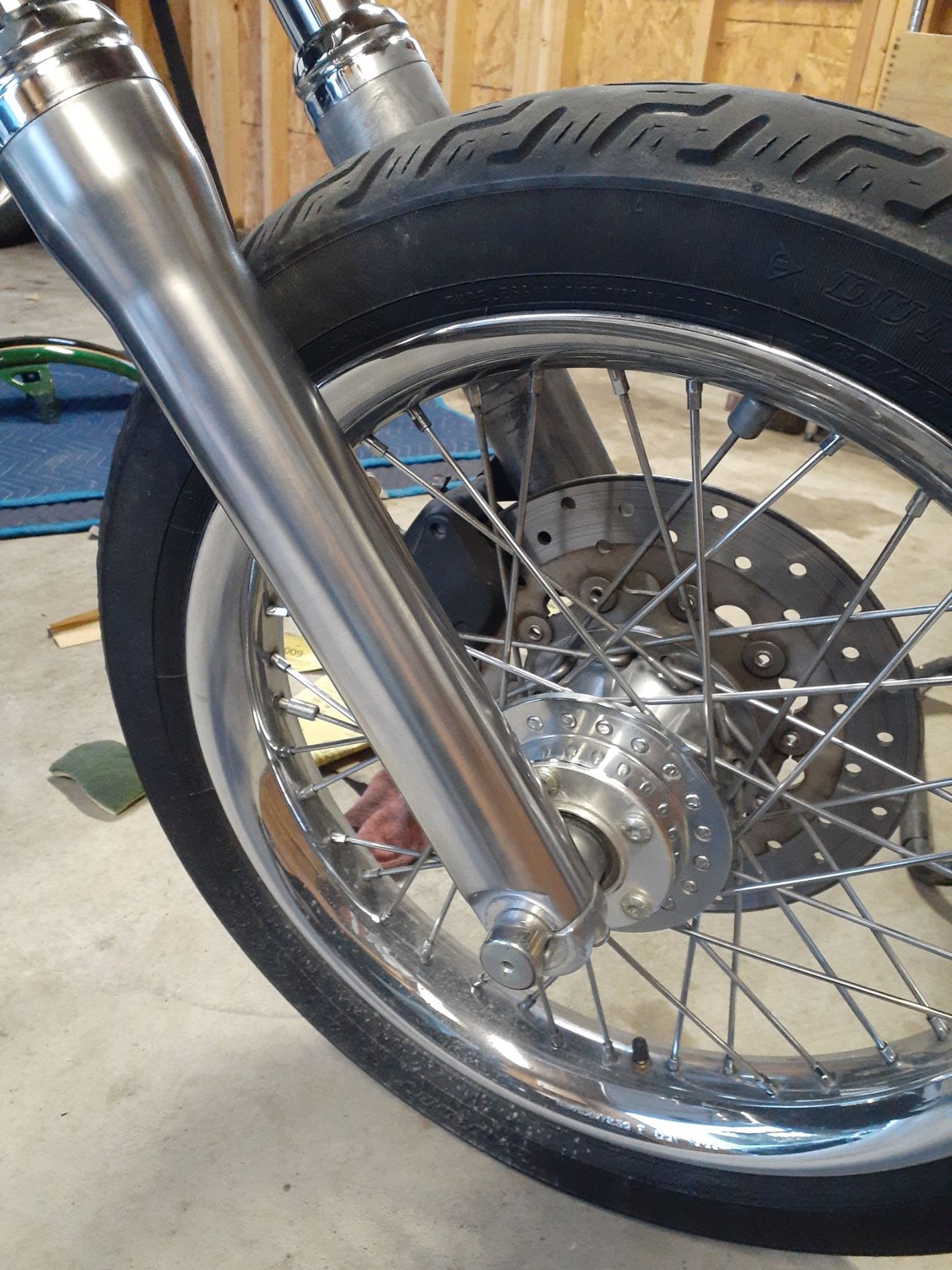

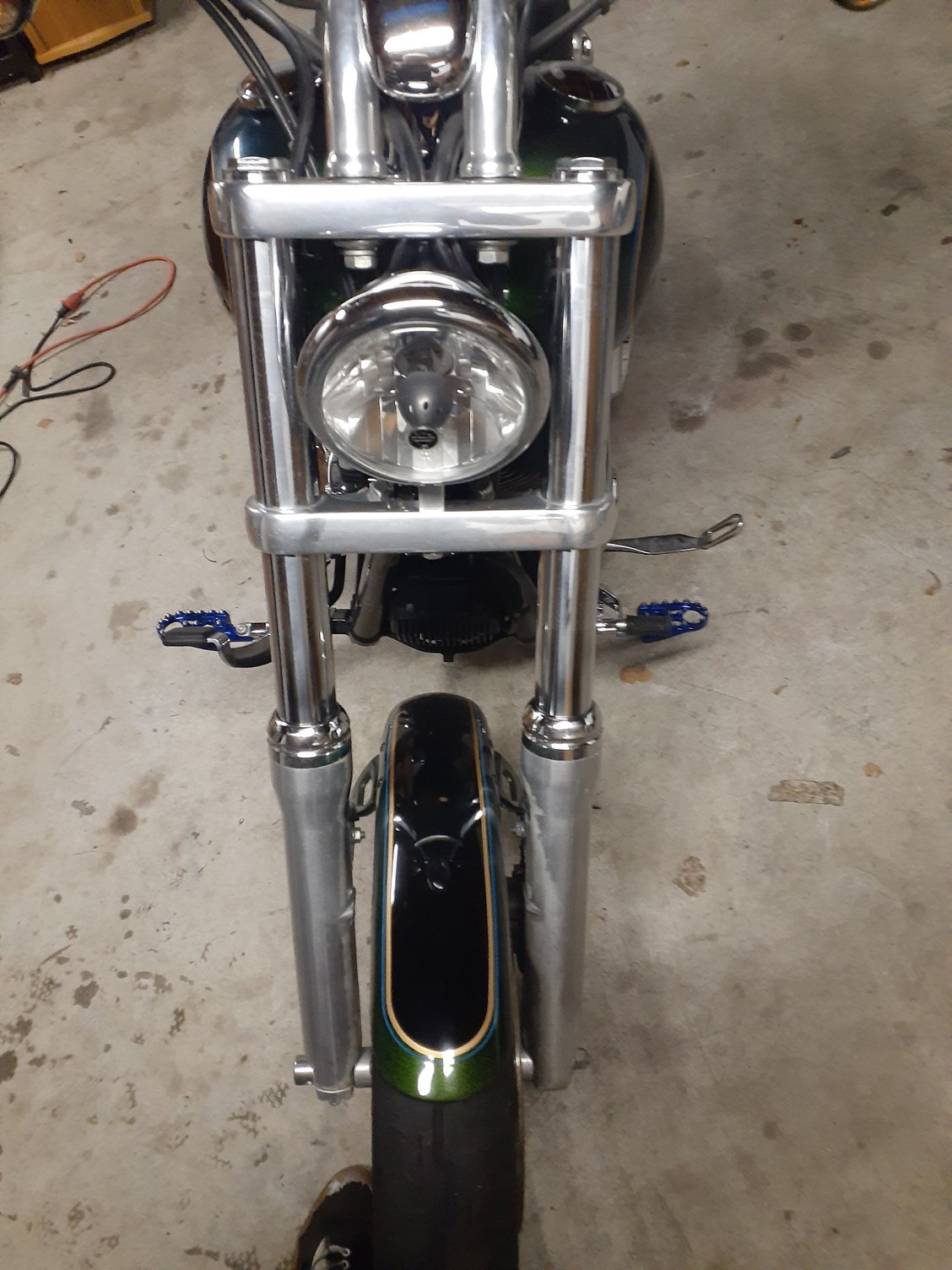

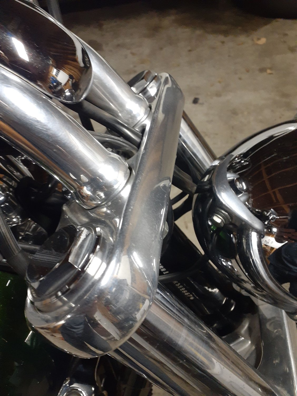

I'm having a really ruff time wrapping my head around why a fxdwg front end is needed to fit a 21 inch wheel on my 06 fxdl. Other option is to relace my stock hub. Cant I just buy a 21x3.5 front rim and tire and just swap it out? I dont k ow if i have a narrow, mid or whatever front end. It seems my 06 dyna low is a funky year because it's the only 6 speed 88ci. Following tear they wend up to 94 or 96ci. Can someone PLEASE explain to me the different dimensions/measurements for my front fork and what is truly needed to throw a 21x 3.5 up front on my bike. Tha is guys.
Fxdl front end. 19x2.5

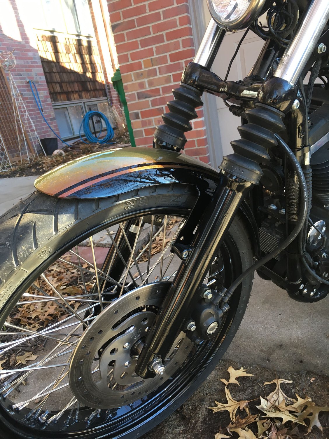

I’ve got a 21x3.5 wrapped with a 120/70/21 on a Sportster with mid glide trees. I would assume you’ve got mid glide trees on yours unless they have been changed at some point.
I ordered my wheel from Siouxicide Choppers who had it built by DNA. It has a Street Bob hub which should fit your application. I think it cost me $550-600ish.
