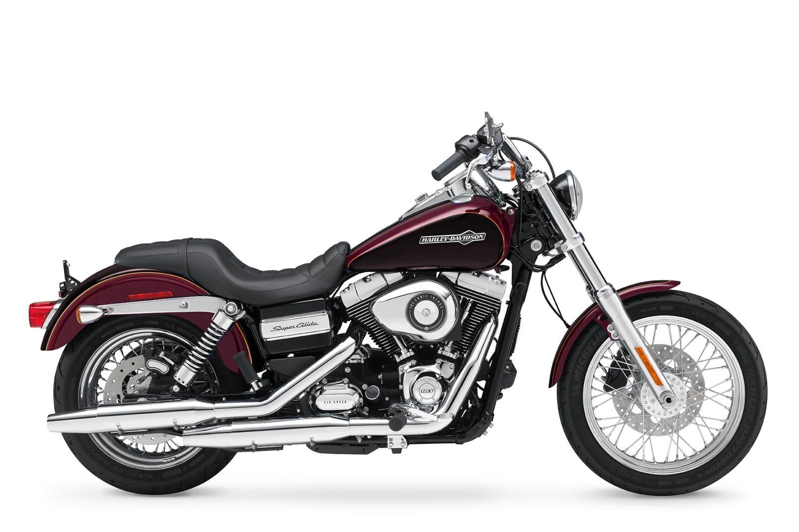

The AMF FXE's were my motivation for choosing a Dyna Superglide. Classic, timeless and nostalgic Harley Davidson style. In some ways, the old Shovel is better bike.
With the exception of mine having the front fender tip trimmed a bit the pic above could be my '76 FXE!
When I bought mine the only color available was an ugly "beer bottle brown" which I left alone until I tipped the bike over and slightly dinged the tank and the front fender.
Amazingly, I used the identical decals on the tank ad the vivid black paint on mine. Had it until it was illegally "taken" in '81
