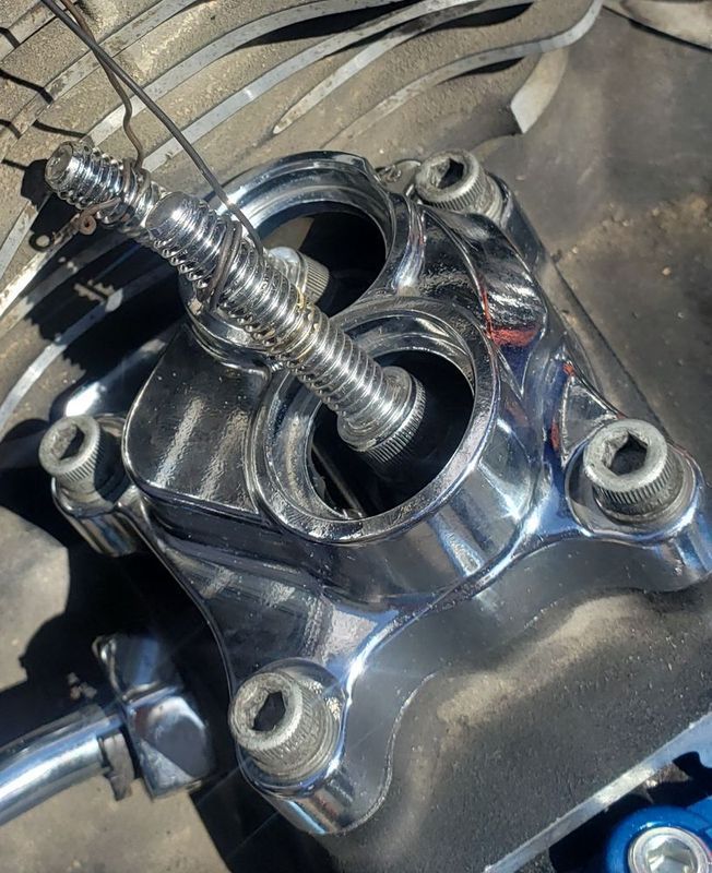

Since I had also already installed the lifters, and didn't feel like taking the covers off, etc... I fashioned some "holders" using small neodymium magnets attached to some old bolts, held up using mechanic's wire. Worked perfectly.
