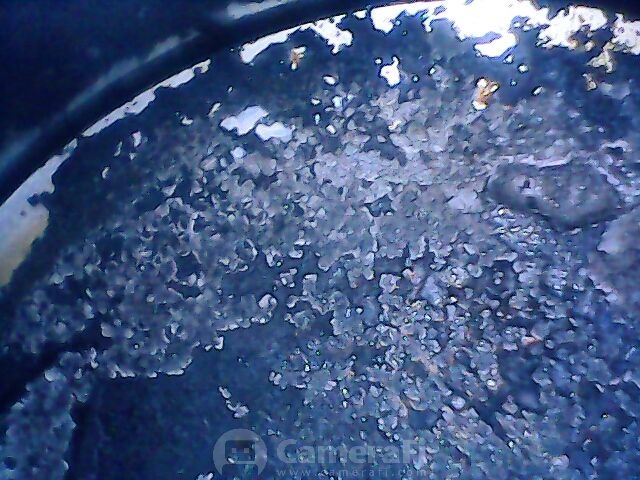

My OCD gets the better of me and when I saw the tuning report showing Knock Retard I used a boroscope to look at my pistons. Saw what I thought was the start of something bad so I tuned it to where there was zero Knock Retard.

[QUOTE=brakeless;19700626]My OCD gets the better of me and when I saw the tuning report showing Knock Retard I used a boroscope to look at my pistons. Saw what I thought was the start of something bad so I (detuned) it to where there was zero Knock Retard.
QUOTE]
Fixed it for you. But, how is tuning out knock retard going to reduce piston carbon deposits?

Funny. Yeah I detuned it. But all I had to work with was the SERT Race Tune that it had on it. Never said I was the brightest bulb in the box. All I know is now there's no knock retard.
