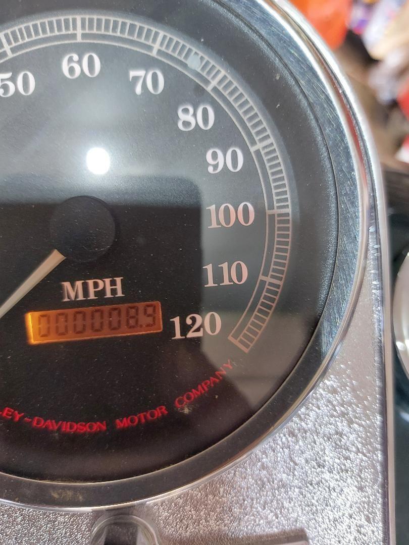

I would be very wary. There's a **** ton of odometer fraud out there, and it's easily do-able on a 1997 bike.

Yes I agree, I have a couple more days until I'm home so I'll do some more checking and get some pictures.

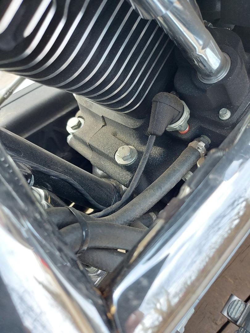

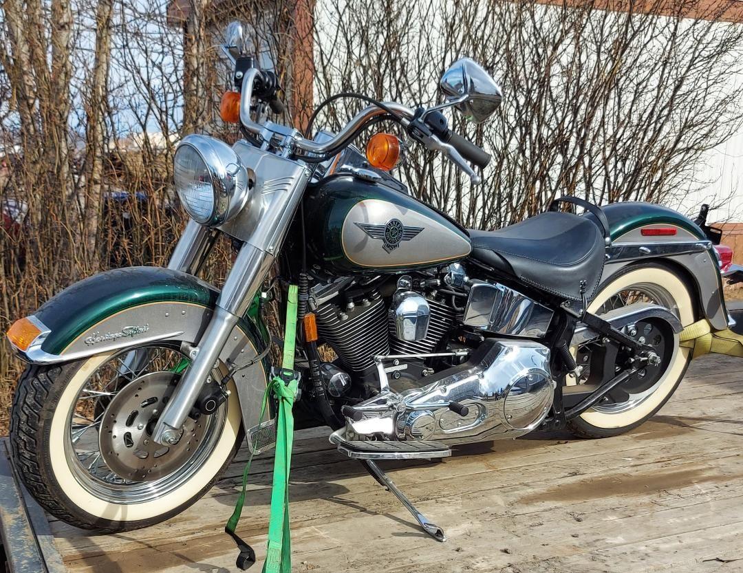

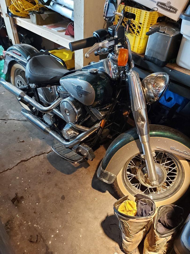

Well the mystery is solved, it appears the bike and four others were bought while the previous owner was on holidays in Vegas. He is from around here and had a going concern business which fell on hard times. The bank came knocking and actioned off some collateral to satisfy the line of credit. This is the only one that was never registered in canada so I have a few obstacles to overcome there. The bike is new, I have never saw one this clean around any areas that get hit with road debris. So my "barn find" aint nothing but a display bike for someone with to much money (credit).

Aside from the dent in the right fork leg, looks nice.

Thats what I'm thinking but I'm also putting a borrow scope down the plug holes to have a look at the cylinder walls, unplug the coil crank til it has oil pressure and hope for the best!
