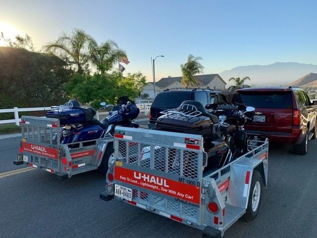

You didn’t mention what model? We just trailered my CVO Limited and my buddy’s CVO RG on our recent 4650 mile trip, and ended up having to rent two UHaul MC trailers as my new enclosed trailer wasn’t built in time.
We used loop straps (one end inverted) anchored around the motor mounts, as Matt Quaid suggested in this video:
Never had an issue - they were rock solid hauling at 80MPH.
These are the loop straps I bought:
Soft Loop Straps Soft Loop Straps
Last edited by tunaman; Jul 15, 2021 at 03:46 PM. Reason: Added picture and link to straps
