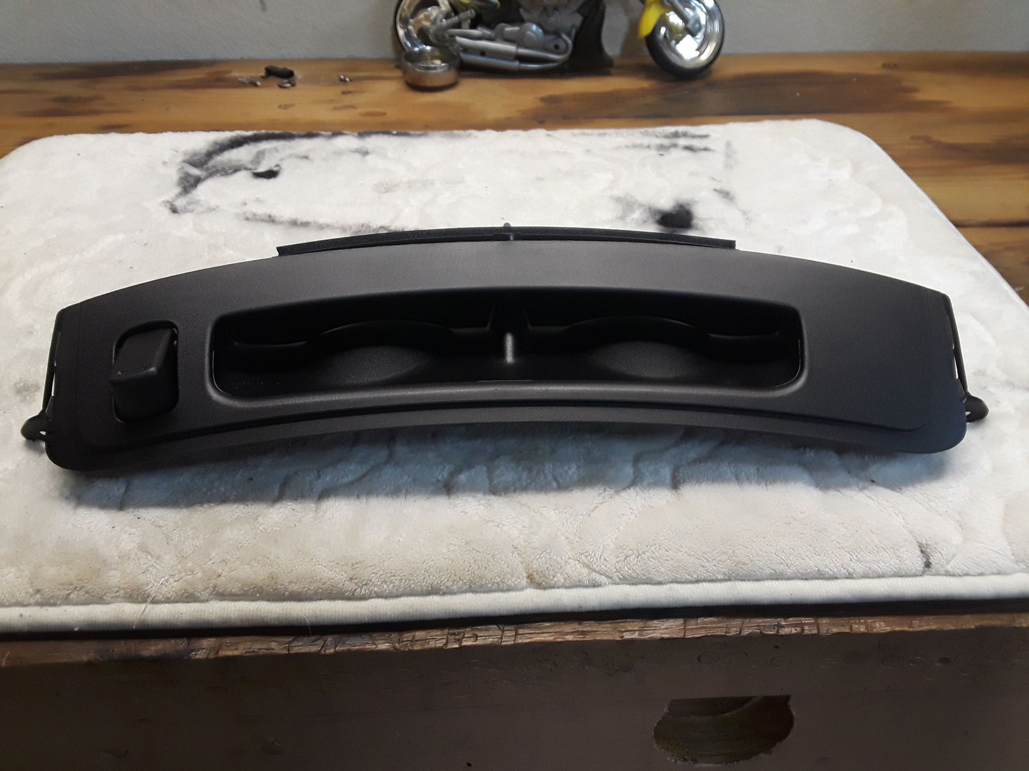

2019 Vent assembly:
I'm sure most of you know what the inside of the fairing looks like but, here a pic anyway. LOL

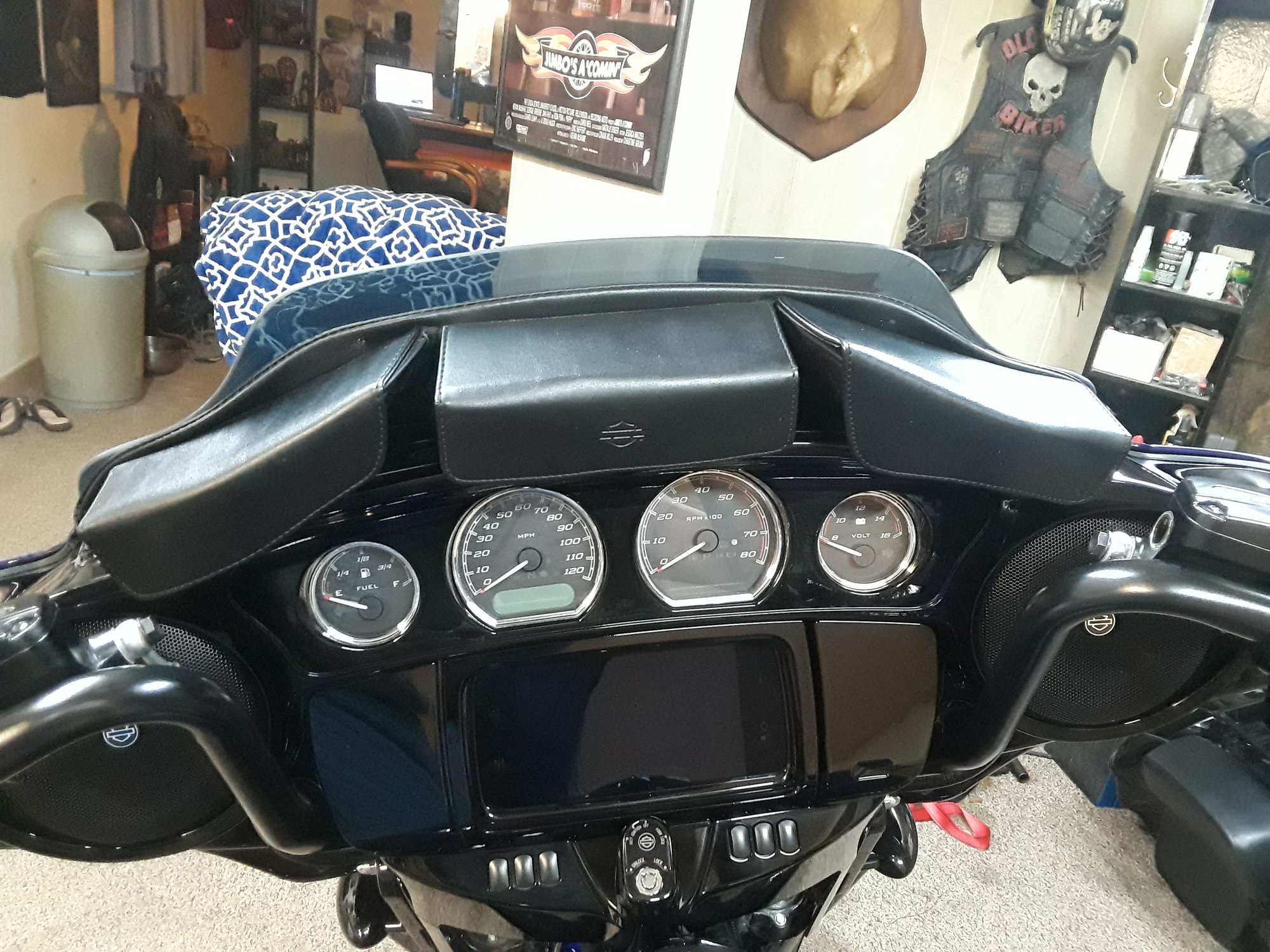

Forgot to take a pic of the assembly installed before I put everything back together along with my windshield bag so you can't see anything with the bag installed and I'm not taking it off for a pic. Sorry. LOL
Very easy install and only took about 15 minutes. Didn't even get a whole beer drank before I was done.

Long answer, I have the 3 pocket windshield bag on my bike. With the vent open , it blows up the flaps on the bag (they are held closed with magnets). One time, they blew open and the air vortex sucked my registration and proof of insurance right out. Had to turn around and go back and find it. With the vent closed, that doesn't happen.
