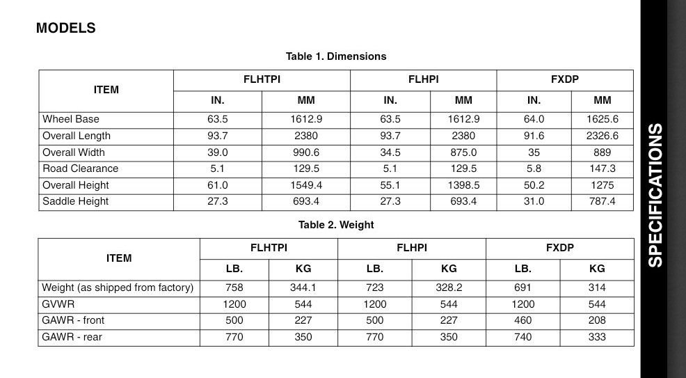

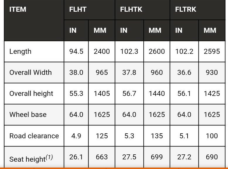

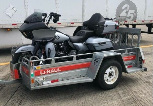

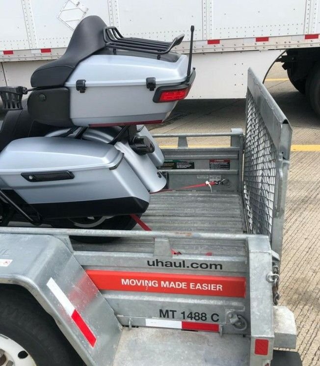

U-haul needs to update their website. There's no way their current MC trailer is only 92" long. Below are pics of a 2020 FLTRK on a U-haul MC trailer. As you can see, there's ample room behind the Tourpak.
According to the Owner's Manual, the 2020 FLTRK has a length of 102.2".
By comparison, the 2004 FLHTP you have to pick up has an overall length of 93.7" in stock form.
