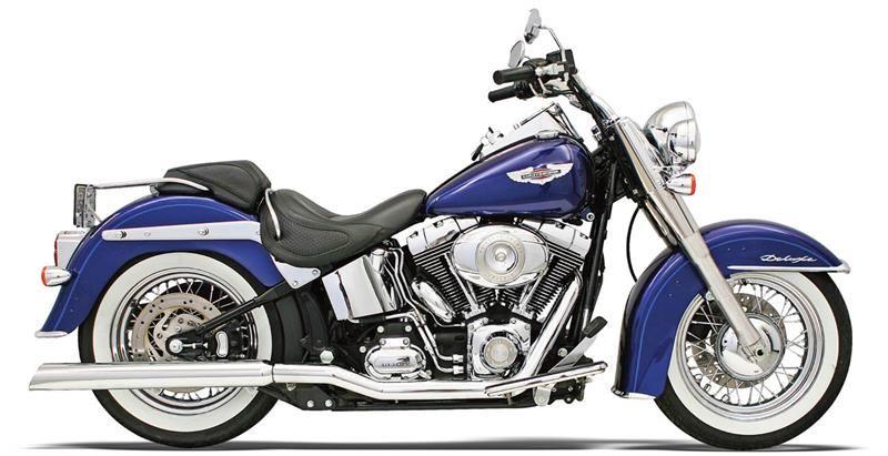

I don’t know much about this setup however from the picture below I think it looks nice and gets the upper exhaust pipe down to the lower left and off the right thigh.
Along with the fuel tuner, long pants, and of course Capt. Itch’s crotch cooler it should make riding a bit more enjoyable.
