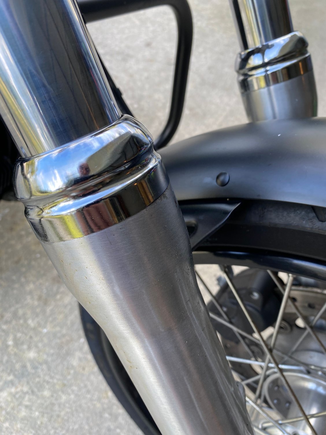

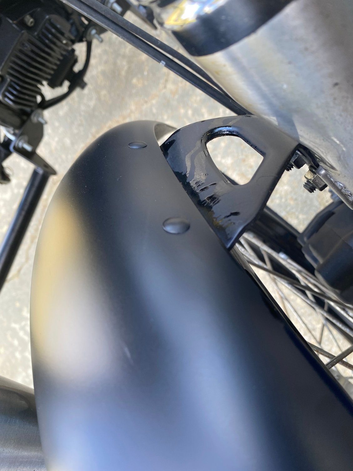

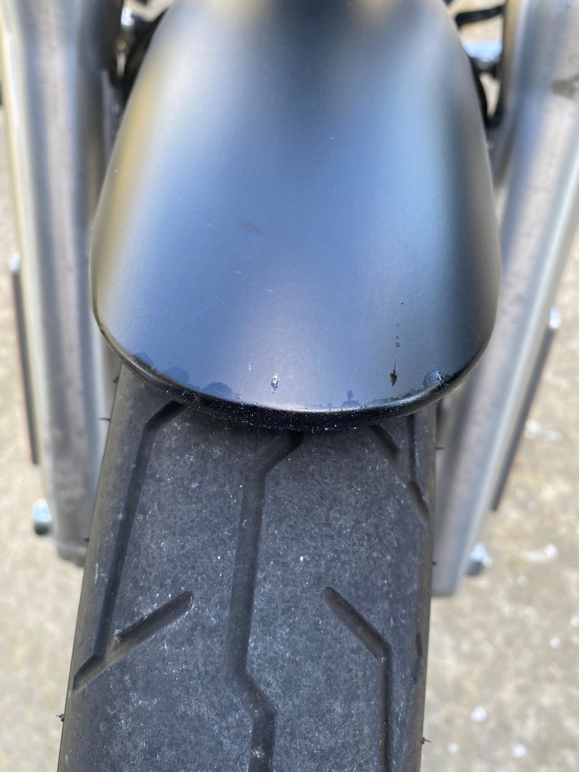

I’m a noob so bear with me. Had spotting on the garage floor and upon further inspection looks like I have some kind of leak maybe coming from front wheel area.
I can’t see anything obviously dripping looking for ideas on where to start. Pics below show color and wear it’s showing up after a quick ride.
Splatter on front fork cross bar
On fender
Front fender lip
This is the color, looks and same consistency of vegetable oil😂
Thanks for your ideas!

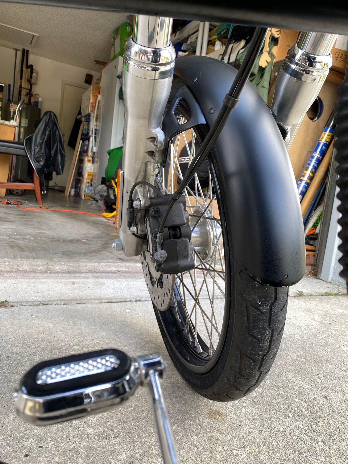

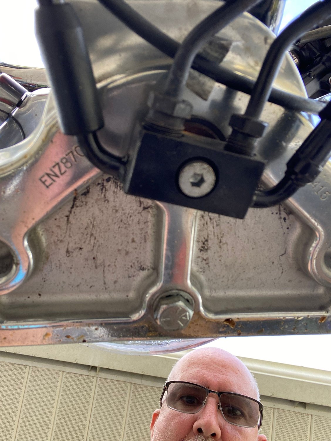

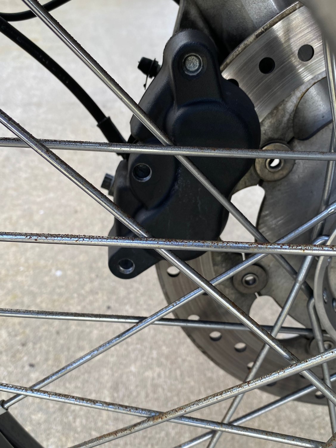

Show us photos of the fork seals and drain screws, the brake caliper(s), and the bottom of the triple tree. As well as provide yr/model info.

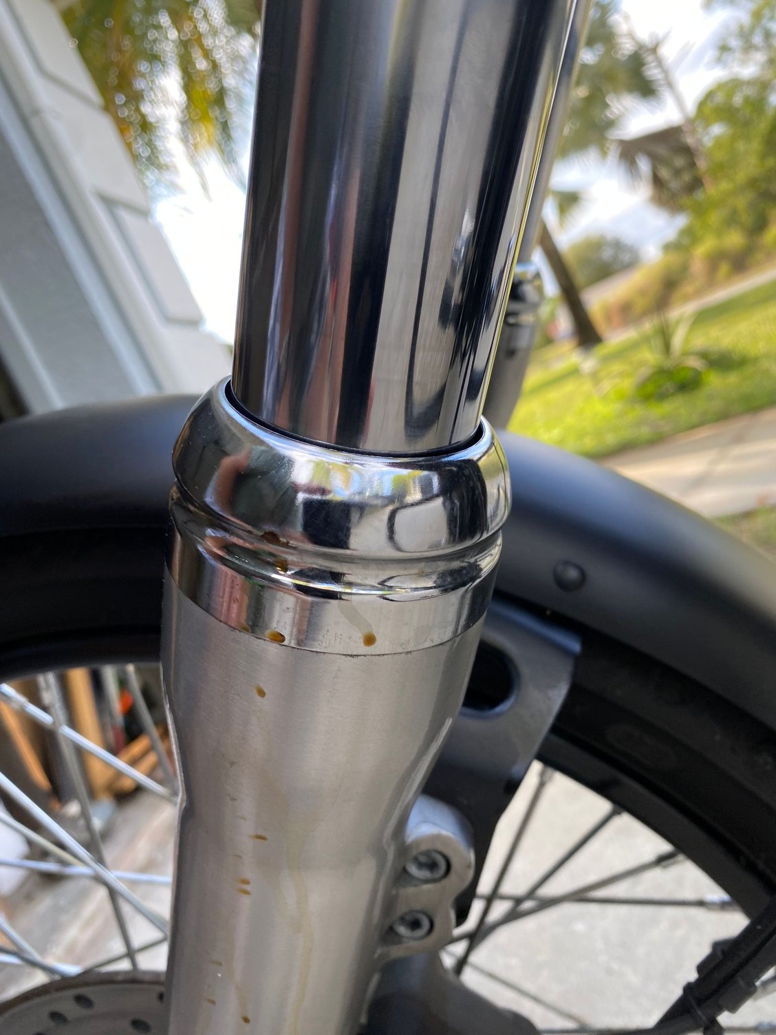

Clutch side fork tube looks like it has oil on it, probably the fork seal on that side. If leaking replace both sides and ride on.
2016 FXDWG Dyna Wide Glide
First pic is clutch side fork, I’m thinking that’s the problem
Yeah it looks like it's just run down the leg from there. Rust and corrosion too. Stored outside before you got her?
