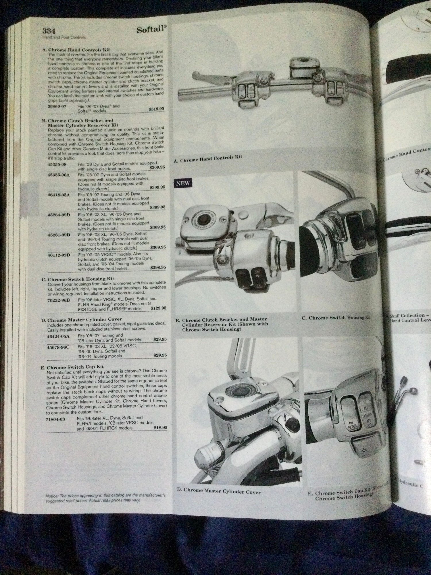

This is from the 2008 HD accessories catalog. Hope it helps. Use the part numbers and search. Looks like for the master cylinder it matters if you have dual disc or not.
