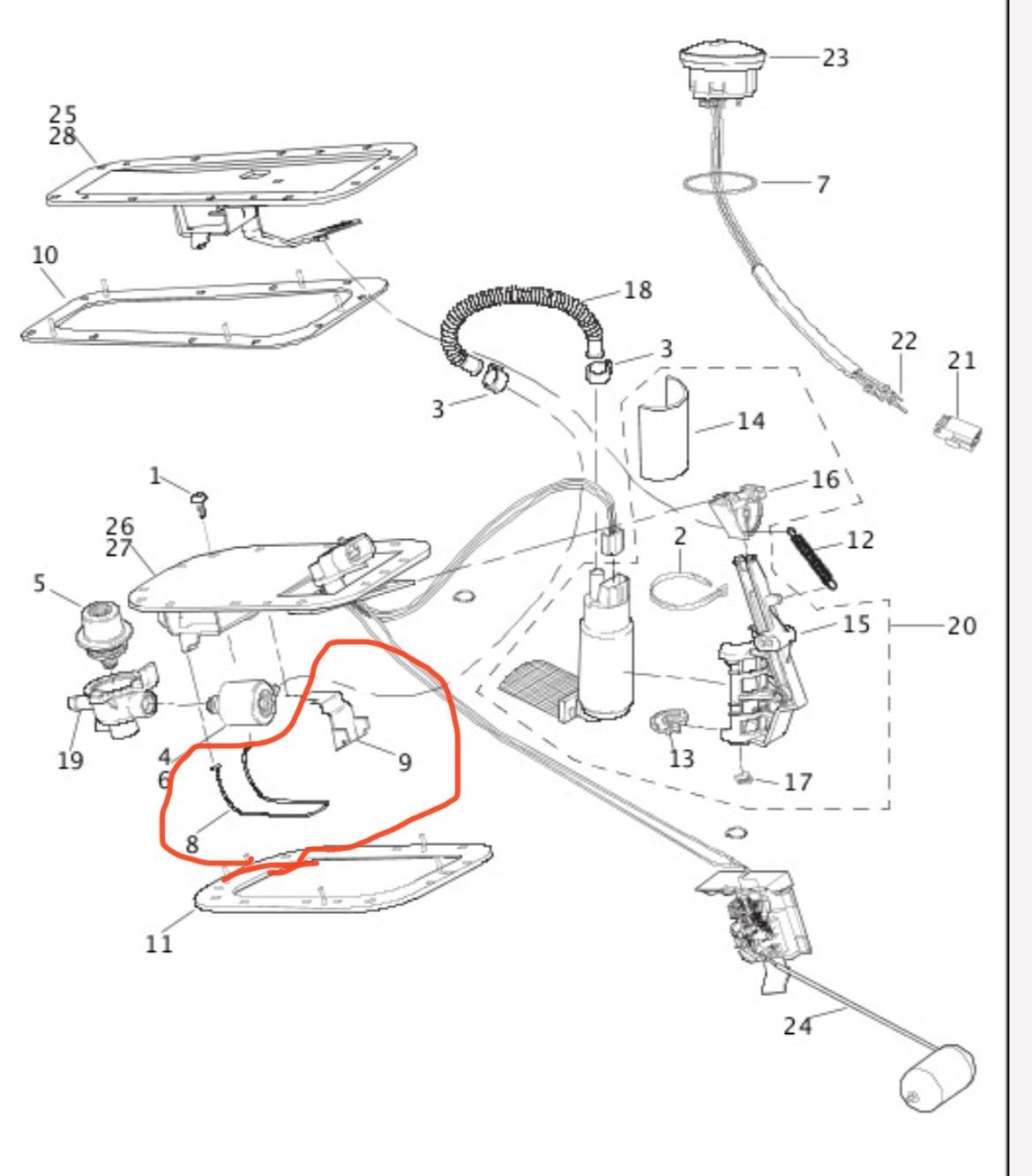

I have a 2006 Heritage Softail FLSTCI that I am trying to get running for my brother who has fell on some hard times. I noticed when I was replacing the fuel filter that the bail and the bail bracket is missing which are what hold the fuel filter and fuel pressure regulator in place. No dealership in the US seems to have these parts and I was wondering if someone has had this same issue and came up with a way to install the filter and regulator without these parts so they will stay in place. Attached below and circled are the parts I am missing.

Guessing that maybe you mean part#
61231-01 bail bracket
61209-01A bail
Odd that parts are missing unless somebody opened the tank and had no idea had to get parts back into the tank.
Are those part numbers no longer available from harley?
If not then a used pump assembly from e b ay should have it.

Harley still has the parts they are just backordered until the end of Sept everywhere I have checked

Like im said, get an assembly off ebay. It doesn't have to be in great shape, or even working, for the parts you need. Beats waiting all summer.

I made my own last night. Thanks for the replies..
