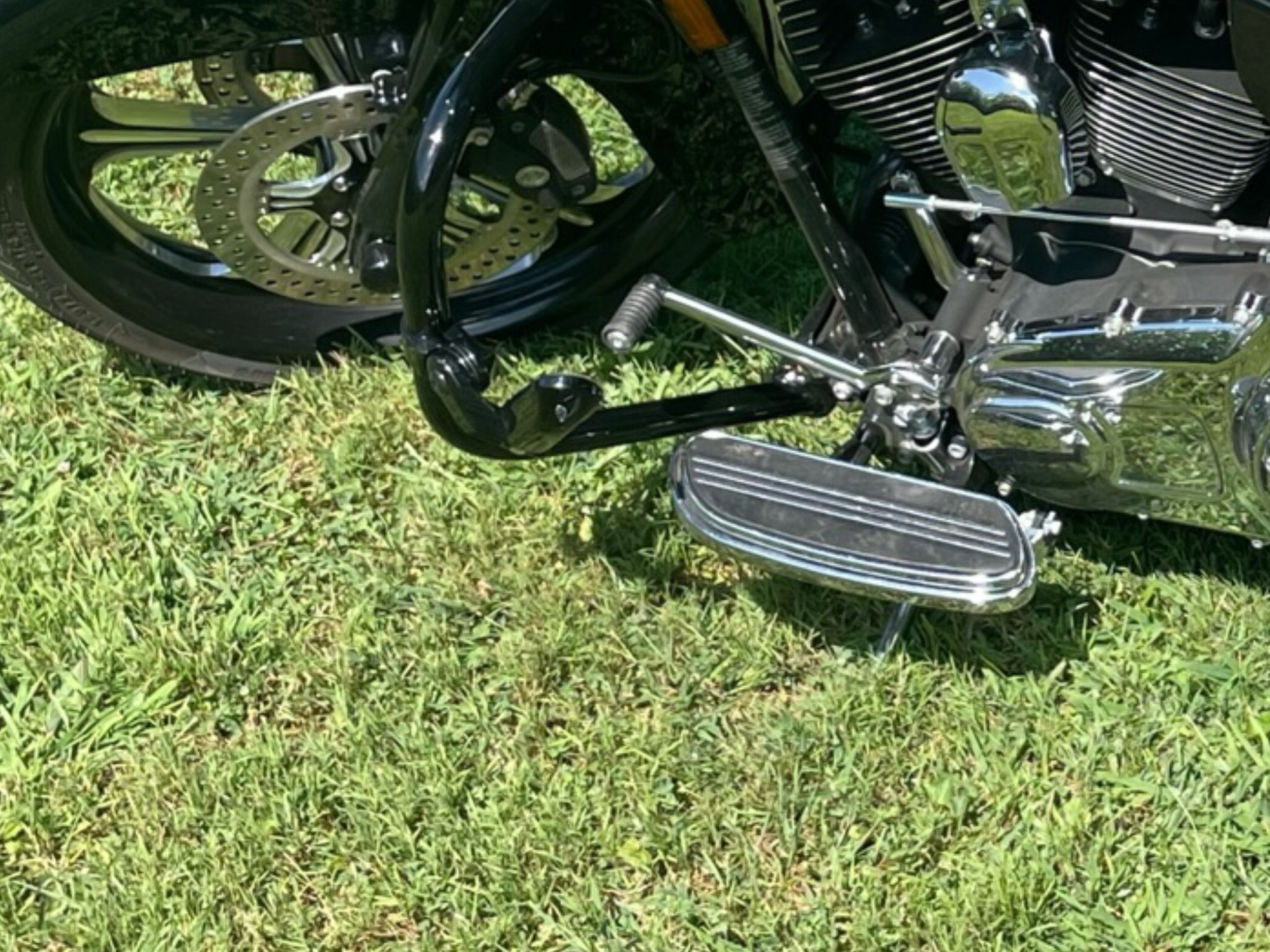

I probably already know the answer (no) but I am finding the shifter a little too close to the toe of my left boot.
Yesterday I bought a pair of boots that just BARELY fit under the shifter .
So close, that I have to kinda scooch it in sideways and wedge my foot underneath. Almost to the point of it not being safe, so that has me saying no to wearing these
particular boots while riding.....if it comes to it. (my other 2 pairs of boots are "ish" but not too bad,.,....)
If I could lower the board by 1/4" to maybe as much as 3/8" I'd be happy, but I am betting they're not adjustable correct?
I have thought of just removing the shifter peg and adjusting it up 1 notch, but my left ankle does not have the greatest range of motion, so I might be asking for trouble.
I don't like the idea of putting a heel shifter on.
Thoughts?
Thanks fellas !

OP - FWIW - get an extended shifter arm. That will get the peg farther forward.
You can also add a longer peg, too
You can also move the arm up a notch to try your ankle out. That’s the only way to know for sure. It’s easy to go back to the original position if needed.
I personally have done the above for my size 14W feet.
But I also like and use the heel shifter.

Ooooh. Extended arm, eh? hmmm, I just might have to look into that. I bet that would solve my problem right away. Even an arm an inch or so longer might do it.
Thanks for the great advice,. You'd think I'd know that there should be such a thing, right?

Extended shifter is good idea. You can also buy floorboard extenders, which will move the floorboard out about an inch. I would seriously try moving the shifter up one notch and see how that works. Sometimes (and I have done this many times) a simple lift of the foot rather than pivot at the ankle will work. Adjust shifter up and try lifting foot along with your regular shift methods.

Why are you opposed to the heel shift?
I was once opposed but since installing and getting used to it, I'm a believer. These too come in extended length to fit larger feet.

Tall Boys floor board lowering brackets work great.
https://www.tallboyscycles.com/
You'll need longer shift and brake levers.

I also recommend a extended shifter lever. I put a V-Twin #21-0256 on my 2010 FLHX and love it! I removed the heal shift lever, got the floorboard outward extenders and the HD forward extended floorboards too. https://www.denniskirk.com/v-twin-ma...prd/579499.sku

What would be the difference as far as you ankle with lowering the board vs raising the peg? You might get a little more gap just adjusting the linkage.
My preference is to use the heel shifter on any bike that has floorboards.

Move the shifter 1 notch, and you can adjust the length of the rod between the 2 shift arms for fine tuning where you want the shift peg.

You might want to get down and look. Some models have two positions for the boards. My '07 RKC did. Looks like you've got lots of options.
