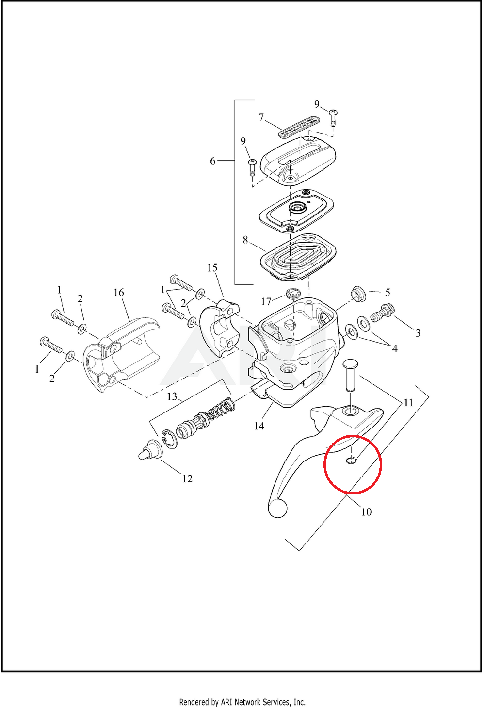

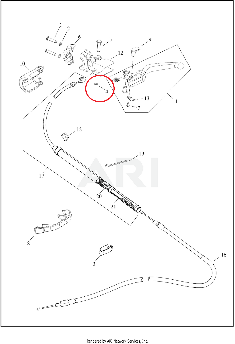

Best TiP: A HD Service manual will assist you greatly with changing the levers. Make sure you follow the procedures for the brake lever as you can break the switch in the housing if you are not careful.
It may not be as easy as just pulling the pin as there looks to be other componets in there (spring etc.) I have not worked on the newer model Harley cable clutches so I can not offer further advice.
You may also want to get a few extra circle-clips (snap ring) as they sometimes have the propensity to spring across the garage and get lost. See below.
Also a good pair of snap ring pliers will be your friend.

Originally Posted by Rounders
I have not done an adjustment on anything newer than 2007. What has changed with the cable clutch?
See self adjusting clutch diagram in Post #6 above.
Old Jan 6, 2023 | 06:42 PM
Rounders's Avatar
Rounders
Joined: Mar 2021
Posts: 18,245
Likes: 3,679
From: backwoods
Originally Posted by CoolBreeze3646
See clutch diagram in Post #6 above.
I did. Looks similar to md. Has anything really changed though? To do this, I would remove the circlip. I would adjust slack into cable same way. Though It was said you don't need to.
I guess what I am getting has anything really changed in the adjustment of the clutch or cables on newer bikes? My new bike is hydraulic.
