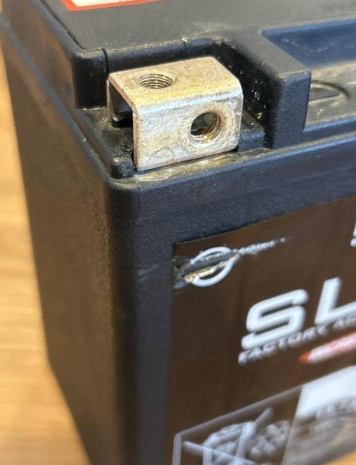

Originally Posted by Tom H
To Tommy,
The terminal on the battery in the picture would just use a bolt and washer, no nut needed. The terminal is threaded and made of brass or some type of steel.
Now....
When you hooked up the battery cables to the battery and tightened the bolts, did they tighten up or did they keep turning? If the bolts kept turning the threads in the hole are stripped and you could use a nut to be able to tighten the bolt.
When you hooked up the battery, were the cables and battery terminals clean? Did you use a bit of sand paper or a knife to clean them?
Now.... If the bolts tightened up and the cables are clean and your getting no power to the bike, the battery has most likely died. Did you have it on a charger over the winter? Have you tried charging the battery since hooking it up to your bike? Have you used a volt meter to see how many volts the battery has? How old is the battery?
Your issue of not getting any power to the bike really makes me think the battery has died, again provided the bolts tightened and the cables are clean. If you have a vehicle with a known good battery, you could use jumper cables to the bike battery and see if that will give the bike power.
Let us know the answers to these questions.
Tom

The threads in the side hole appear buggered up when compared to the never used threads in the top hole.
