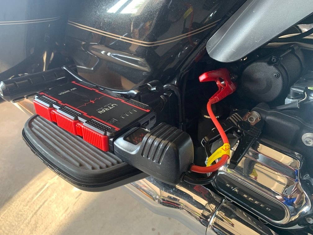

Originally Posted by WONKEY
I carry the GB50, the GB40 works fine, I use mine on the bikes, car/truck (cummins) and boat. I also have the pigtail on my wife's 2019 heritage, I have one for my 2004 fatboy that I need to install, got the 14' SGS I can just connect it to the starter post and ground.
Couldn't you connect the booster unit to the starter post and ground on just about any HD? I have the HD branded unit. I haven't had to use it, but if I did, I would connect it to the starter post and ground on my 22 CVO trike.
I use this method for connection should I ever need it and can use it on other Harley's as well should they need a jump.
DIY Tool. See below:
+1 Just like this. Easy.
https://www.youtube.com/watch?v=I5Nn736TYJs
I watched the video and the tool seems like a good idea if the starter post is difficult to get to. Mine is wide open and easy to reach. I'll just hook the booster clamp directly to the post if I have to jump it. Thanks for your response. Eases my mind that I won't be blowing up the trike if I have to jump it.
On the touring bikes the starter post is easily accessible, on the softtails they are not, I'm not sure on the dyna's and sporters, on the softtails you will need a long piece of flat steel covered in tape or shrink wrap (to prevent grounding the bike) to reach the starter post, to me it is just easier to run the adaptor cable.
