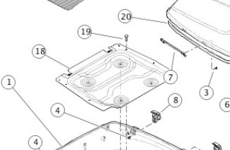

That maybe something i consider. I take mine off alot..but if the nuts were maybe tack welded and i could just pop the 4 bolts inside the tour pack. The qr is fine around local..but i pack alot and put a big bag on my tp...the fixed mount makes me feel better. And I'm taking off several states away
My TP is the Harley branded King. Not sure about others, but it came with a metal plate inside that has four threaded studs welded to it so all I have to do to remove it is undo the corresponding self-locking nuts from below. Easy five minute job. The plate I got with mine looks like the image below (HD #53000091) except the fiche shows loose bolts (go figure, find someone that has a small spot welder). I've tried Amazon el'cheapo Tour Paks which came with a basic rectangular plate, loose bolts and nuts, and with the rough--cast hinges and other issues I ended up returning it the next day (many others report good luck with them though).
The fixed mount, besides being less expensive overall, provides easy access to the two rear nuts (something the removable one did not). One thing I can guarantee you is that with the fixed mount, that bag isn't going anywhere! Even this mount pops off the mounts with four additional bolts and can be done with the saddle bags installed if you use long-stem Allen or Torx drivers (I forget which type it comes with).
