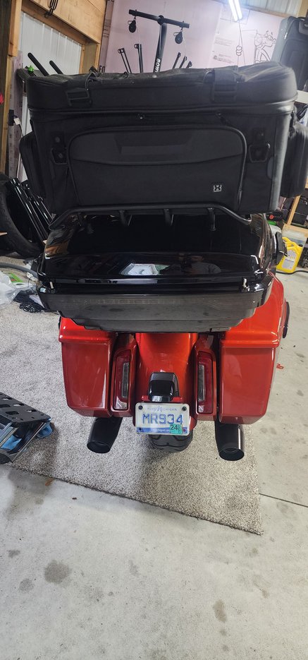

I've got a Harley king tour pak mounted with the Harley quick release hardware. I just did a 2,500 mile trip with the pak loaded up. I even had a small suitcase tied to the luggage rack. There were no problems. Everything stayed tight.
But.. I am a bit OC about the hardware. Every week or so, one of the preventative maintenance things I do is to check the quick release screws to make sure nothing is coming loose.

If you're traveling solo, don't forget to pack the passenger seat for the heavy stuff. We just did 16 days over 6k miles with a 23# bag on the rack and 28# in the box. This is our 3rd dresser with combined 200k miles and no problem so far. 1 bike had the qd hardware with a little play without a passenger. Buy was never a problem.
