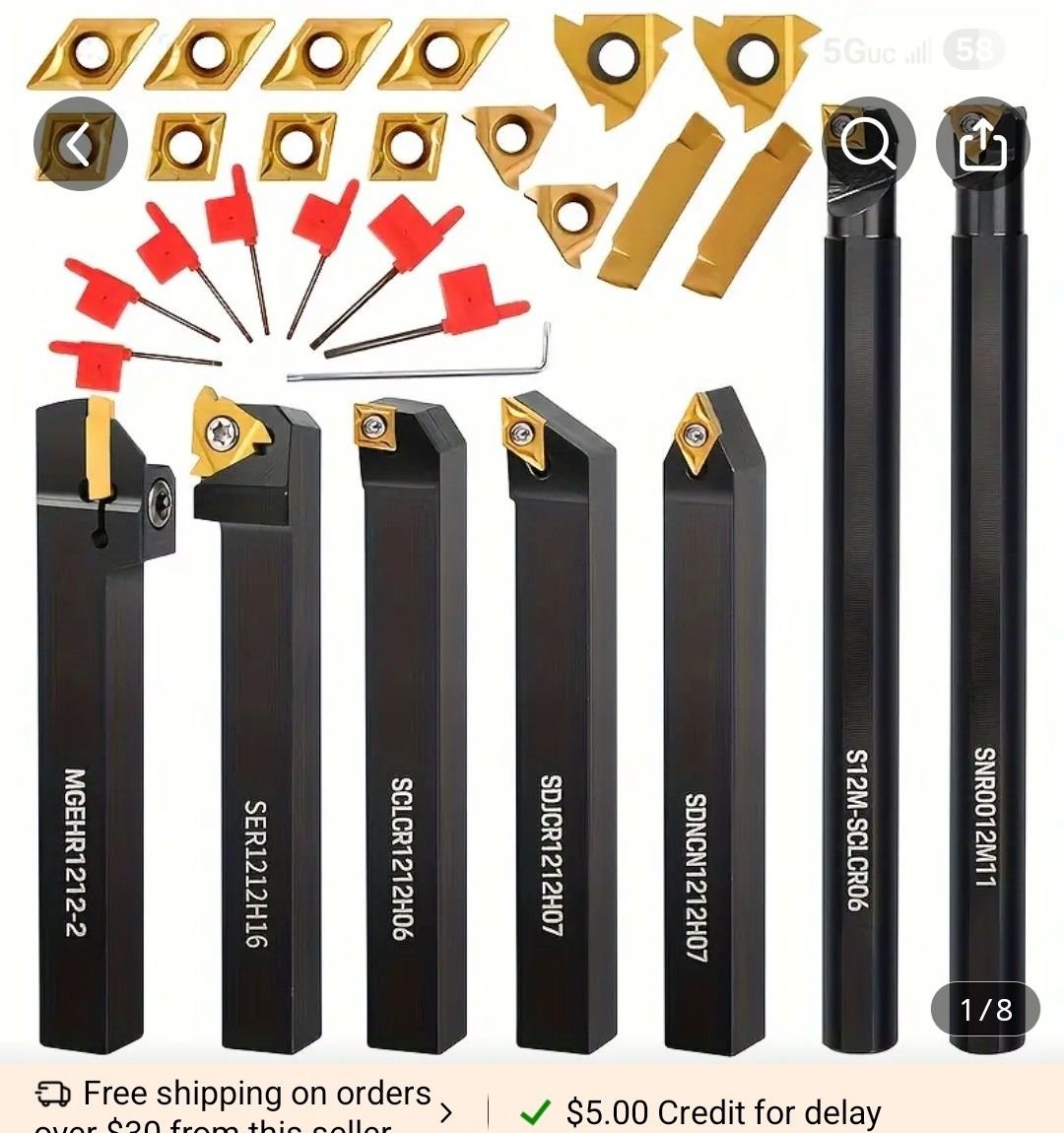

The rigidity is a loose term.. Not sure how rigid the head stock bearing that supports the lathe chuck. And as long as the slides are precise, the gib that snug it can be set so there is little play thru out the movement.

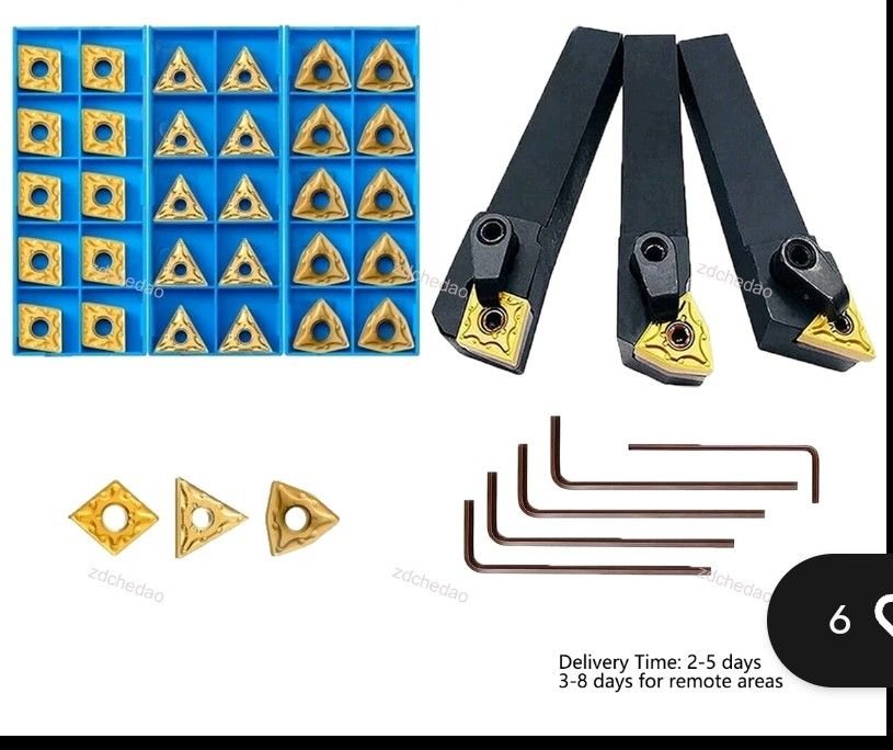

Good sharp tools then would do a good job. Carbide tools cut with lot more force. Now they make some with good chip breaker but using tooling like that is quite expensive.
They are however ready to go out of the box. Not really intended to be resharpened. However, they can be touched up with a diamond grind wheel or a special carbide grinding wheel usually green in color.
Carbide also comes brazed on shanks
And that little lathe just may cut with them..

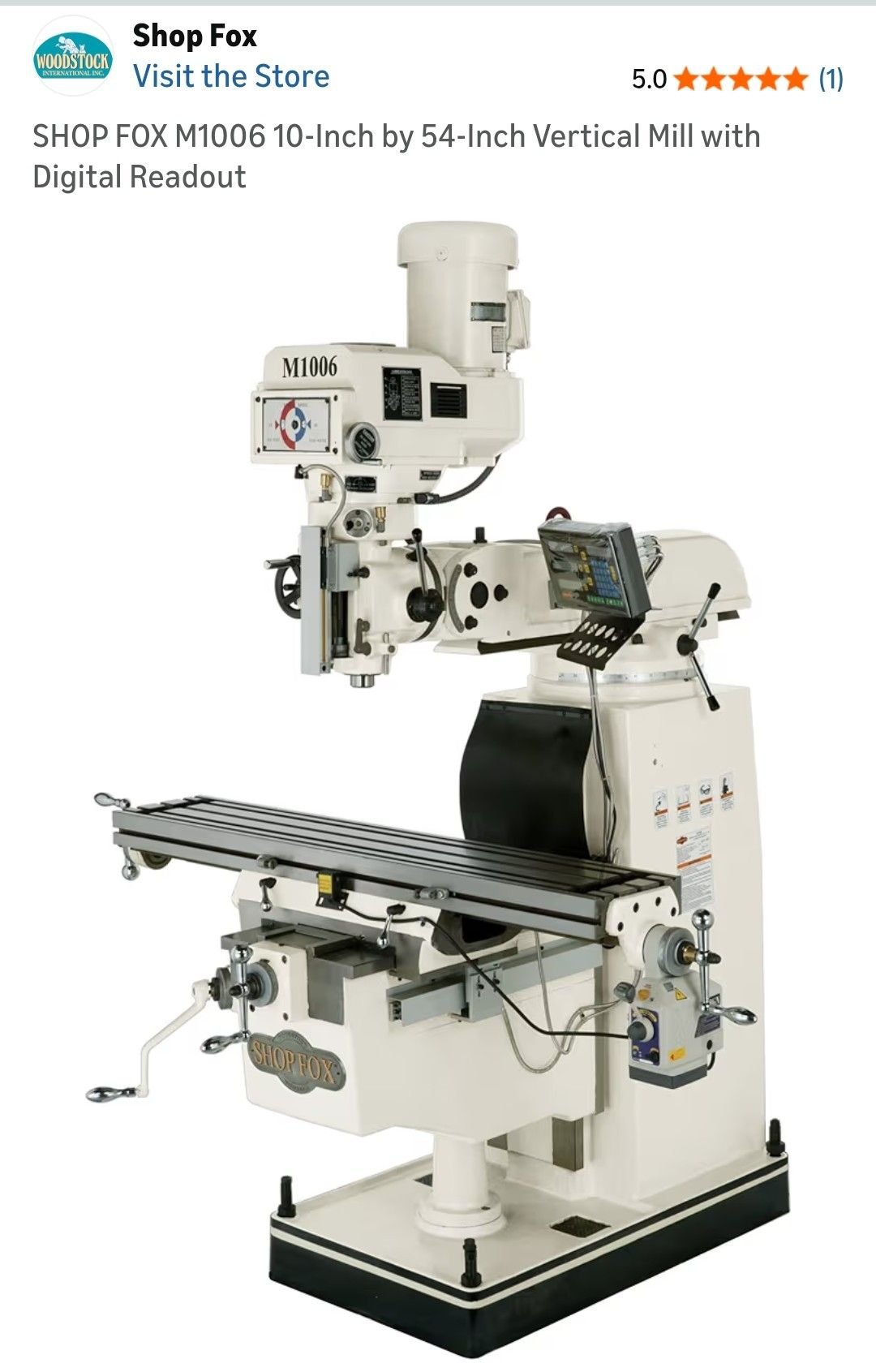

I purchased these two machines, a three phase generator and their power hack saw in 2012 when I retired. Figured they would give me something and my oldest son to do.
Still running fine. I never found the time or desire to mess with them.
