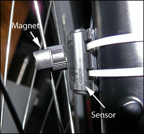

check your local inspection laws in respect to the turn signals, up here anything built before 73 doesnt require turn signals. also i used a bicycle speedo for mine to pass inspection
http://www.amazon.com/Schwinn-SW654-.../dp/B000DZD3FQ
in this pic you can sorta see it on my bars right between my risers
this pic shows the sensor installed on the fork and the magnet on the spoke
once it is calibrated it is accurate up to .5 mph and also has trpmeter, odometer, max speed, avg speed, temp readout, backlight. passed the local safety inspection as it was functioning speedometer. if you go that route though DO NOT get the wirless one as it wont read properly
