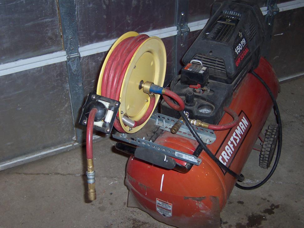

Another advantage to that set up is that some of the condensation will collect in the fitting. I did mine the same way except I have an 8-10" pipe before the valve. This makes more room for condensate to collect and also makes the valve easier to reach (it isn't under the tank anymore).

Originally Posted by 95custmz
How bout some pics?
OK, How are these? While I was getting these I decided to add a couple of another addition that may interest some. It is a 25ft recoiling hose reel. Before you ask if is from HF:, sale price is around $40.
Attached Thumbnails Compressor quick blow down-100_0510.jpg   Compressor quick blow down-100_0511.jpg   Compressor quick blow down-100_0512.jpg   Compressor quick blow down-100_0513.jpg

Harbor Freight had ( don't know if they still do ) an automatic blow down kit for compressors for around $25 . I picked one up yrs ago , takes a bit to install but my compressor is hard mounted in an insulated shed beside my garage I flip a switch & don't see or hear it but for the monthly PM I give it .Works great , just heads up .
piasspj , nice addition on the hose reel never crossed my mind to do that with one I had laying around Kudo's man . I just hung it up by the garage door when I moved my noise maker out to a locked shed .
