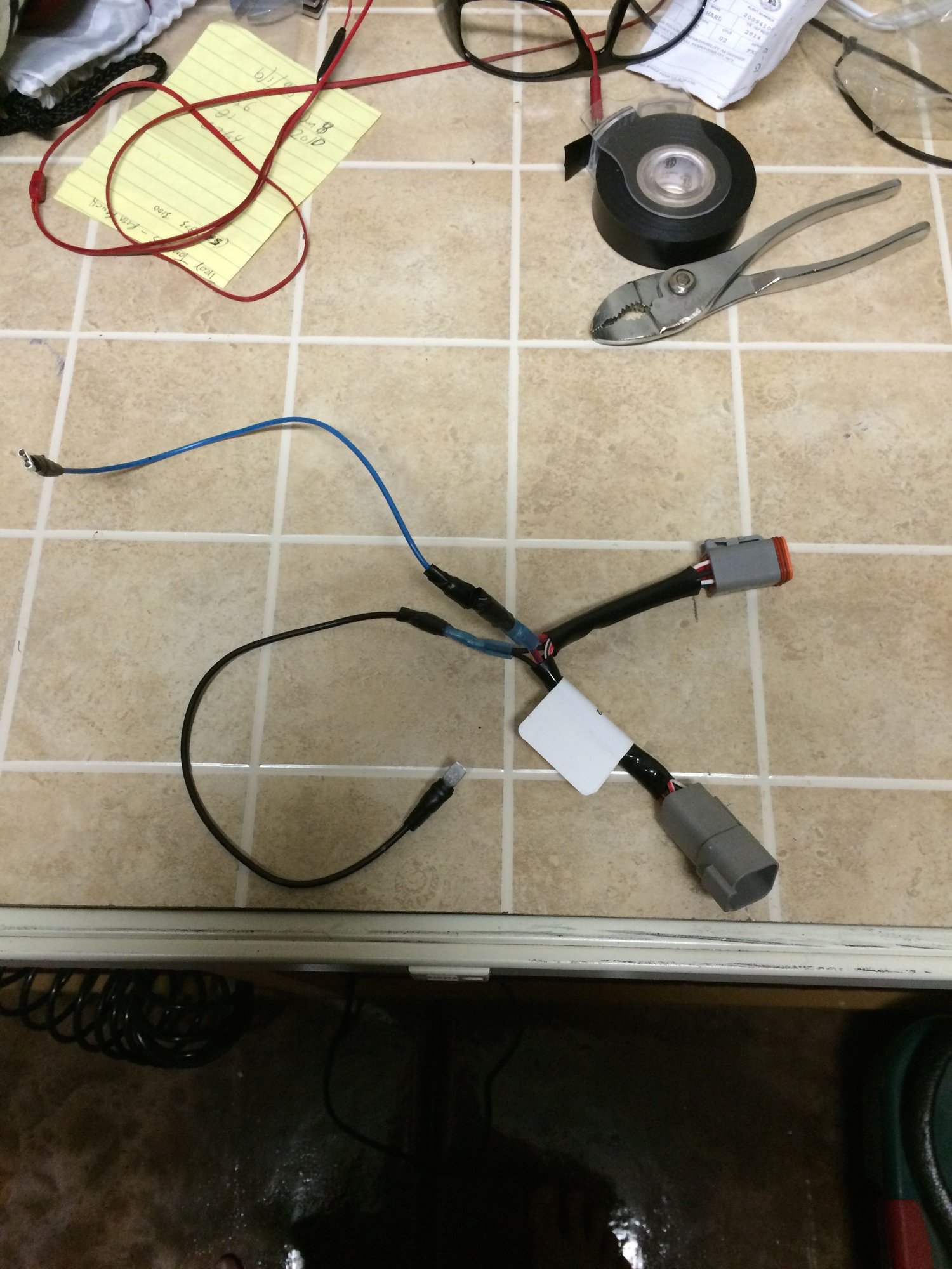

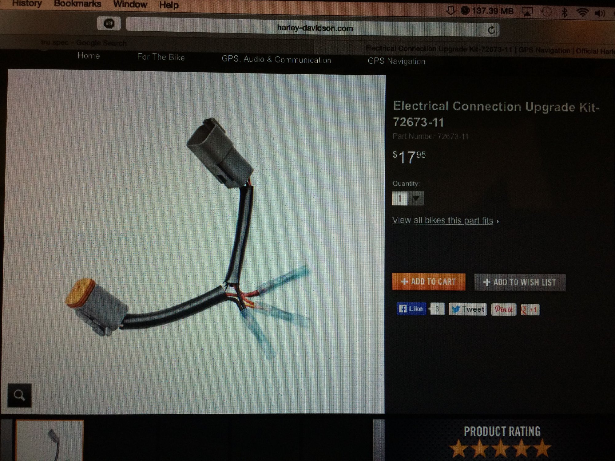

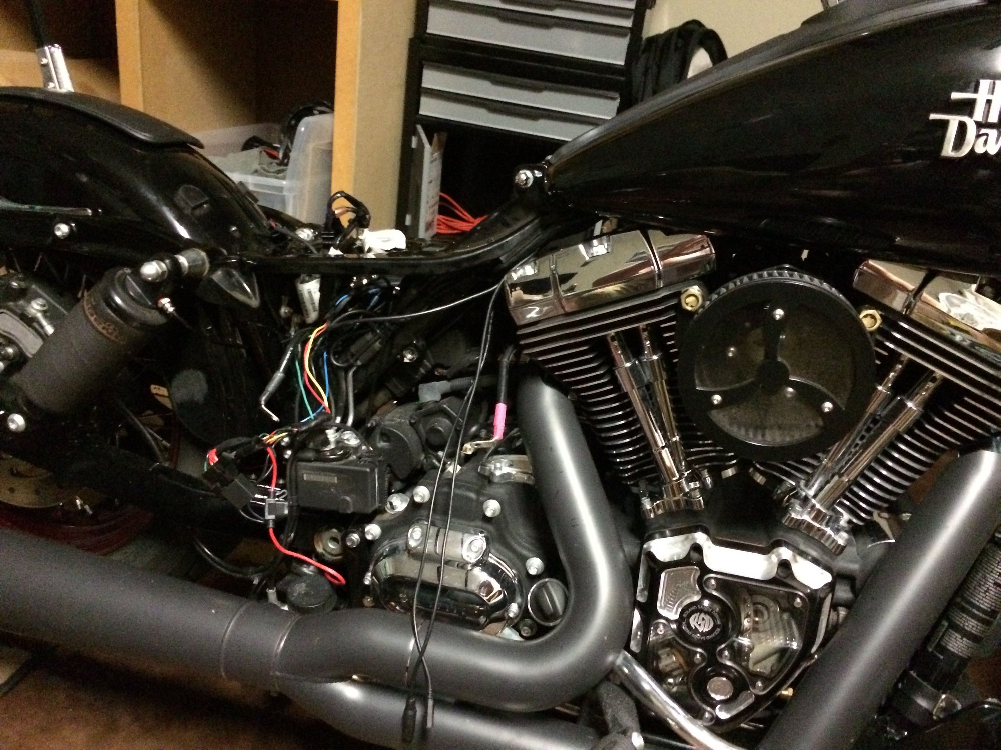

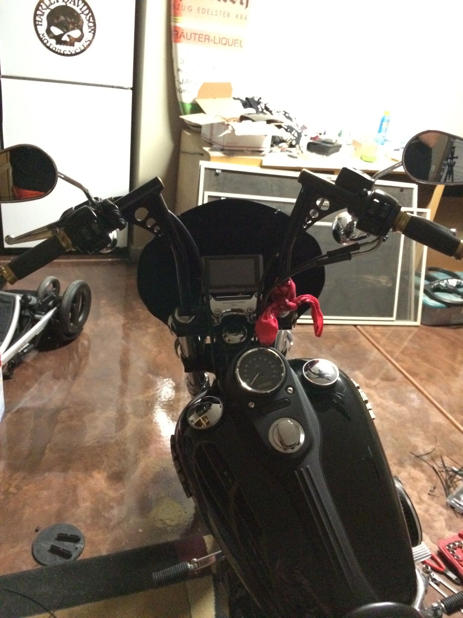

I just installed a zumo 665 on my street bob. Used the ram mounting system with the zumo motorcycle cradle it came with. My SB did not have a accessory plug so i used part #72673-11 so plug into the data link plug to draw power when the key is on.
Ran all the wire under the tank to under the seat pan for a clean appearance
Really easy job to do, just took me longer to find a plug to run power from. Your bike may have extra plugs under the seat just for this. My gps is right under my quarter faring and works like a champ.

I really dig that setup, center mounted like you have. Unfortunately I am putting on a mount similar to yours but being used for speedometer, tach and cut for remaining gauges. Like I said in my post I have the HD handlebar mount but just seems to take away from the cool factor when you are running apes. I may have to change things up when I get my bike back on the road, hopefully within the month. I do still have a ball mount that I bought when I first using a GPS that I have thought about but my apes are being painted as well and I sure do not want to screw with the paint.
