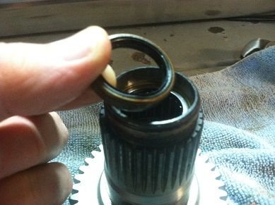

Remove the inner primary bearing inner race from the mainshaft, don`t reuse it.
While the inner primary bearing inner race is off the mainshaft:
Replace the main drive gear seal (it seals the space between the main drive gear and the mainshaft) Note: this is the seal most guys overlook, because it is well hidden.
Here`s a pic of that seal:
that main drive gear seal is easy to replace if you've got the gear out (as in your picture), not so easy if it's still in the case and still on the mainshaft.
One question, Dan, why replace the pulley spacer?
