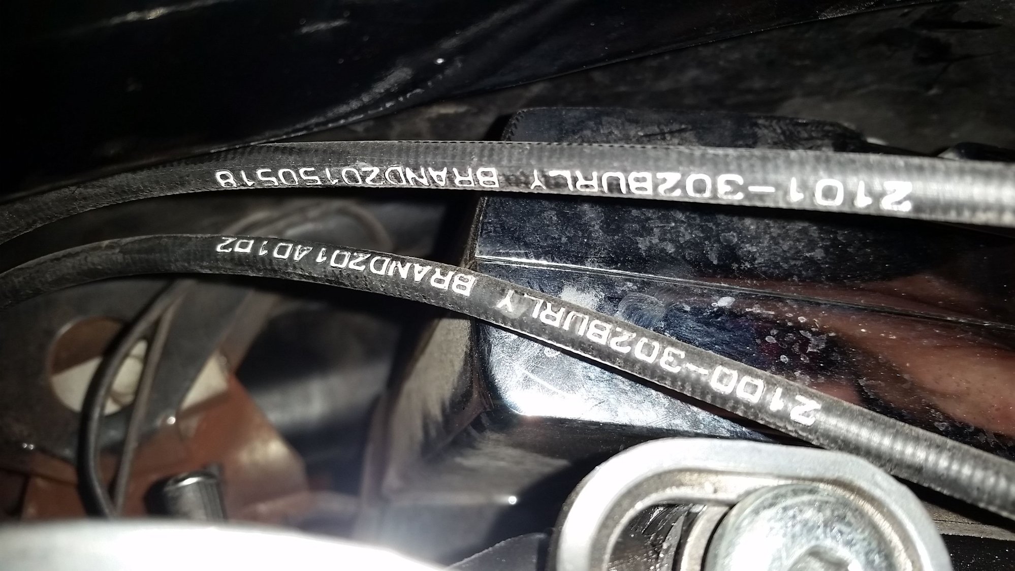

Where can I find Extended Cables for an 94 with an S&Se. I currently have Burly Brand installed but Burly no longer makes them for bikes older than 10-15 years back
I have these installed currently.
Measured by string:
one has cable length of 52" in a housing length of 48"
other has cable length of 53" in a housing lenght of 49"
