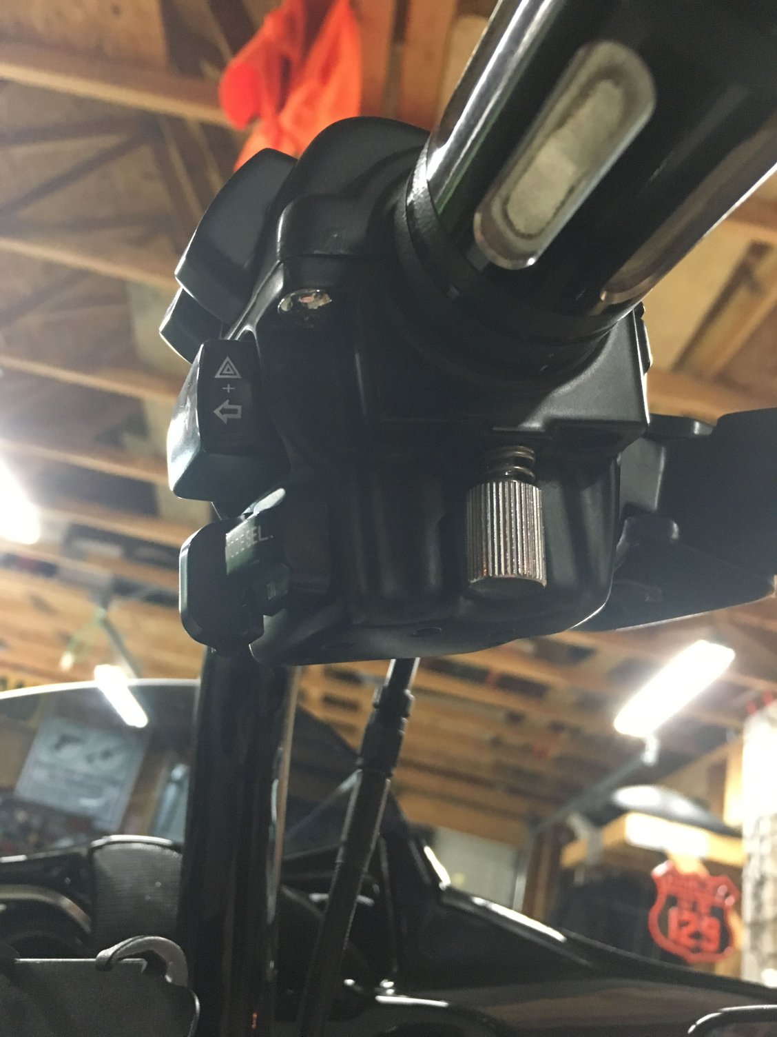

i just bought a 2008 Street Glide and do not know what this is. It is the round thing that looks like it spins to do something Please Help

Poor man's cruise control, aka a throttle lock

Ok Thanks. I thought it may be but the bike has a electronic cruise.

It's a friction device. If you screw it out your throttle will snap shut as soon as you release your grip. Alternatively you can screw it in just so, to catch the twistgrip so it doesn't snap shut. You could try to use it as a crude cruise control, but that is not what it is for.
Thanks for the info
