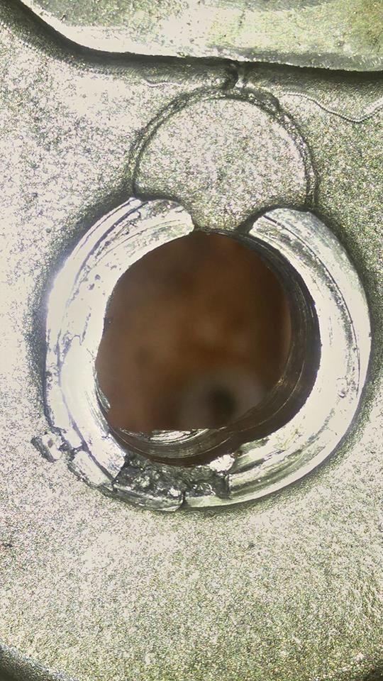

Countershaft bearing went out and took out the bore for the bearing. Anyone have any tips on this?
I plan on having it welded up and either putting in a metal sleeve and boring that to size or going thru aluminum weld to size.
Zippers performance is telling me a sleeve is the way to go. My Welder is telling me welding wont be a problem
Also I have the original trap door to go off of for location and the aftermarket zippers trap door
Which would be better for locating?

Wow bummer I would use the original trap door for alignment and good luck

Steel sleeve and bore that to size.
Getting a used case is also an option.

Used case is not an option. Everyone I have seen doesn't have the cam cover and then there is the cost of putting the crank in. No cam cover = line boring additional bores in the cam chest. And the only issue I have with a steel sleeve is then I have 2 bores to size in and keep parallel. Still needs to be welded up on the face and bore as well.

As to the bike it is a 1988 sportster hugger, The counterbore bearing went out and the countershaft took out the hole. This is most likely due to me breaking a countershaft over a year ago. I fixed the transmission, replaced the bearing but missed out on the hole being weakened, that is my theory anyways.
I have to split the case. Then have it welded up. I think what I am going to do is strive to shoot the bore in the welded case and if I cannot get it withing .0005 parallel and .001 location then I will enlarge the bore and try it again with a steel sleeve
