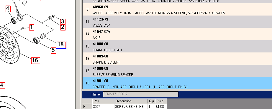

Question, I have a non abs 09 road king classic. Yesterday I removed front tire. I noticed two different size spacers. the shop manual lists one size spacer part number 41901-08 ..... I have always had the dealer do tire installs so, could it be that they put a incorrect size spacer on by mistake? or are the two different sizes correct? thanks in advance

Should both be the same.

They should be the same unless someone replaced the wheel, left the ABS bearing in and shortened the spacer.
