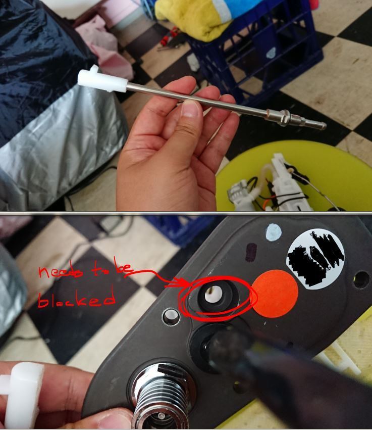

I am in the process of transplanting 2018 street bob fuel pump into 2016 forty eight gas tank.
Because the overflow pipe is built in as part of forty eight gas tank, I need to block off the extra over flow from 2018 street bob. which is built into the fuel pump module. (see pic below)
This pipe screws right off and left the screw hole at the bottom of the module. (see pic below)
I'm trying to figure out the easiest way to block this screw hole in question and came up with following option.
1. find a same thread sized screw + o-ring and block it off with loctite.
2. cut the pipe short and cap it with.... (your recommendation here please)
Now, I need some reassurance from anyone who's done this sort of thing before and see my options above are do-able, bearing in mind that these will require to work inside the gas tank.
as mentioned, easier I can do this the merrier.
Thanks very much in advance guys.

i think you have it covered with option #1. that way, if the need arose, reversible, say you got a new tank!

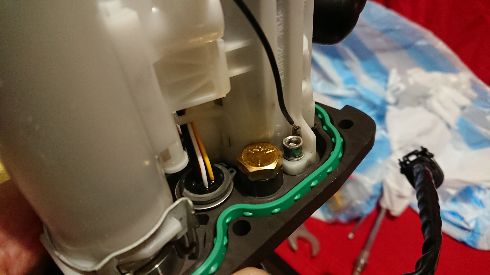

bunged it off with 3/8 x 3/4" unf bolt with existing o ring.
heres what it looks like. worked like a charm.
