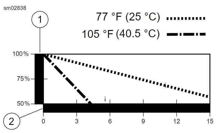

Batteries have internal leakage, At higher temps they discharge faster.
From the HD battery install sheet.
If the battery was low to start with and not charged over winter, there can be serious harm done.
