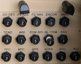

fuses!!! hummmm??? better carry spares.
https://sep.yimg.com/ay/stylespilots...breakers-6.jpg
https://www.aopa.org/-/media/images/...t_breakers.jpg
manual reset, visible trip, can serve as a theft deterrent
Yep, last I looked there was still a FAR requiring you to carry spare fuses, for each type used and replaceable in flight.
