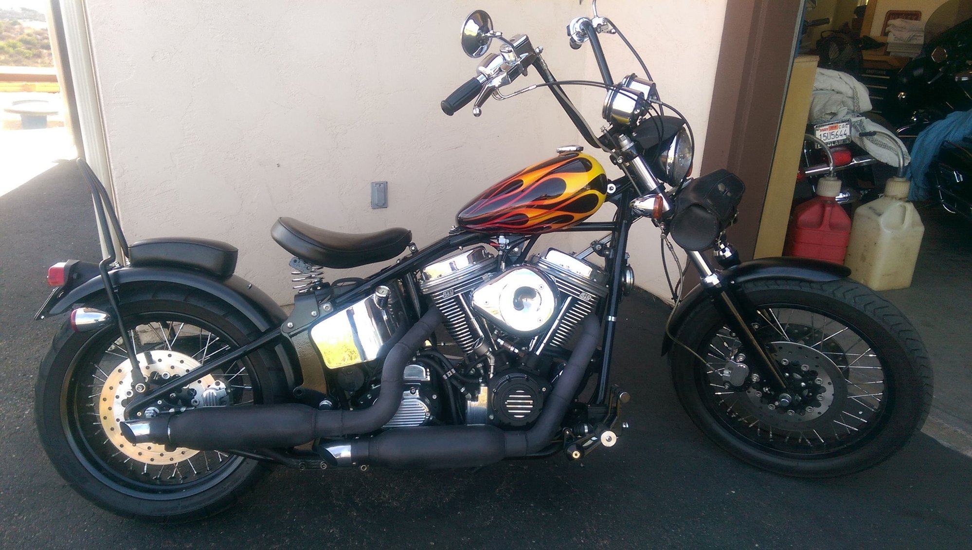

These are a Choppers.
This is not. Somebody threw on a raked set of trees and some longer tubes. A lot of guys were wrecking with raked triple trees back in the 70's and 80's. Now I see they've been coming back. Scary. If you're going to do radical stuff then do it right. Stretch the frame and rake the neck.

You can make the *** end look like an old rigid and still keep the softail.

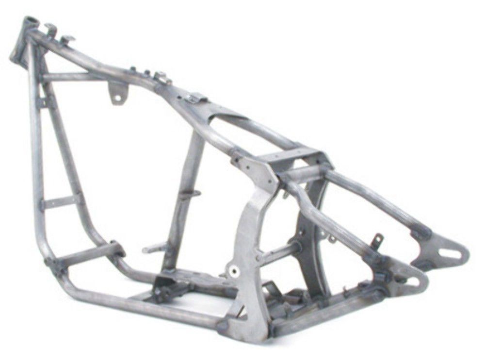

Max,
Where are the spring/shocks hiding?

This is a standard softail.. The shocks hide under the tranny. All HD softails are the same way except for the 2018 M8 softails. What is weird is that the softail shocks work in extension instead of compression.. The softail swingarm pulls on the shocks instead of compressing them like standard swingarm frame.
Here is a pic of an aftermarket softail frame.
