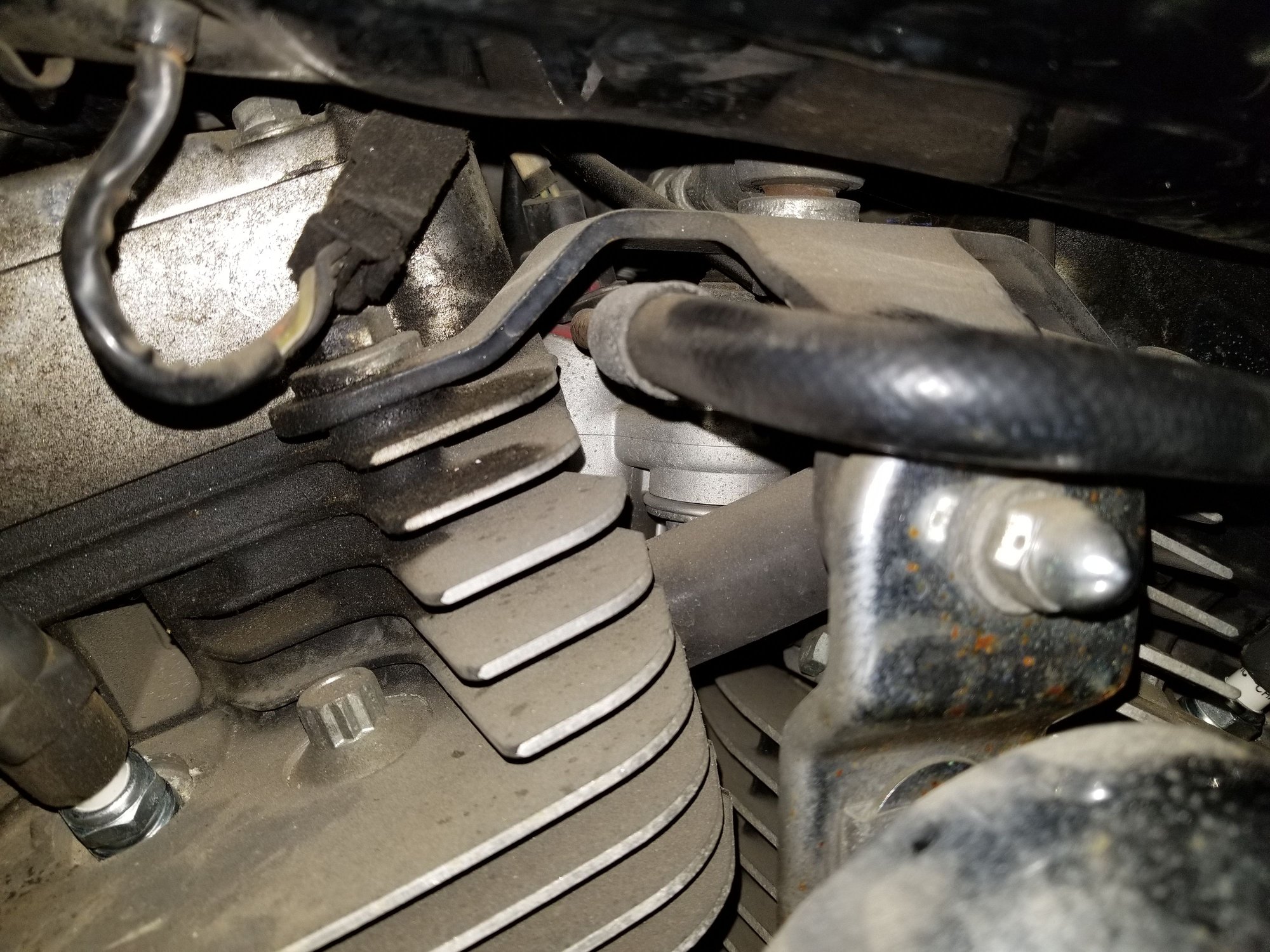

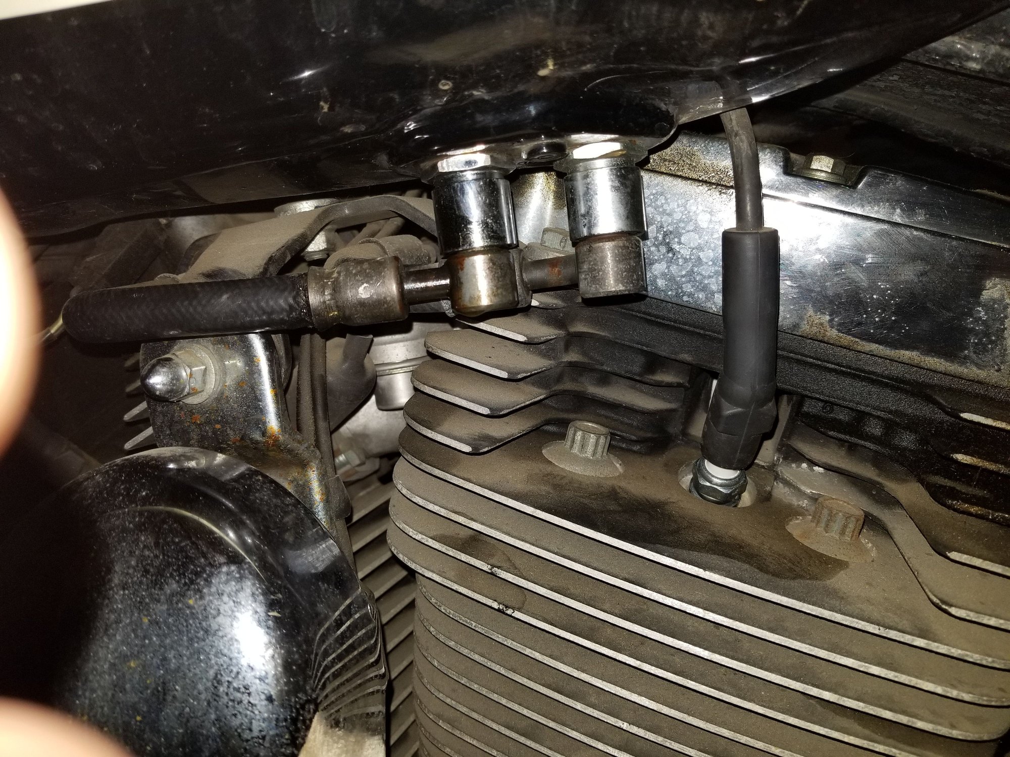

Originally Posted by Zerk
There are no vacuum lines. it gets sucked through fuel hose. Not sure when they went to that system, but that is what it looks like to me. Though not sure what 2nd port is for either.
Was always funny before vacuum *****, guys would turn their gas **** off, and forget to turn it back on.
What I think needs to be done, is either shove something in petcock to open it open, use a vac pump. But I am speaking from my bowels right now. But you will not be able to test fuel pump vacuum **** is open.
Zero, look at the pics i just took.you can see just two lines, they both go to the same location on the TB.

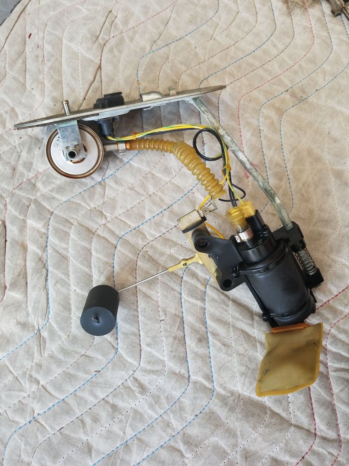

Well I've got some good news, after doing more reading last night, I decided to take the fuel pump out... guess what I found! See the pic below...
Old Aug 25, 2018 | 04:06 PM
  #35
svshaw82's Avatar
svshaw82
Joined: Jul 2018
Posts: 79
Likes: 23
From: Lake Elsinore CA
Seems to me, that this perfectly explains the no fuel problem! Lol!!

Update, it's running now! Thanks to everybody for the help!
was a bit rough at first, but smoothed out. I think that was from the old fuel starting to clear the lines. Either way, its running now. I'm very pleased. Thanks again guys!
