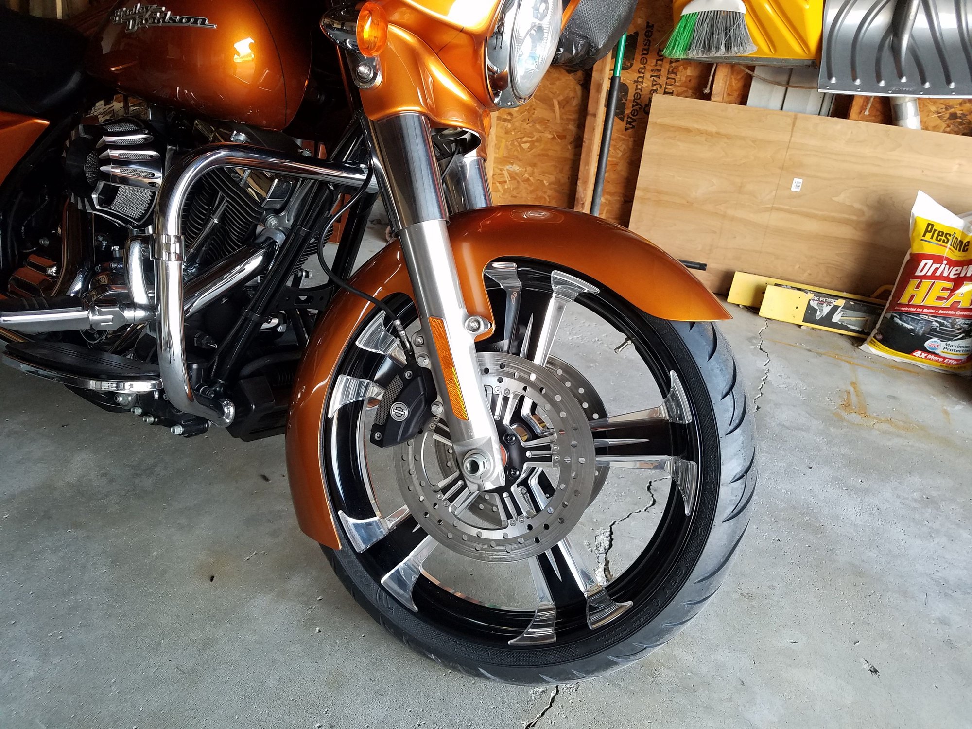

I just put a bad dad full wrap on my sgs with no issues. Is the rake that much different on a rk? I did however get a spacer ( for lack of a better word) from bad dad to mount it. It is a 21" tire also. I have a friend who rides a 07 sg with a 21" tire with the big ol stock fender without issue, and his is in the factory mounting holes.
