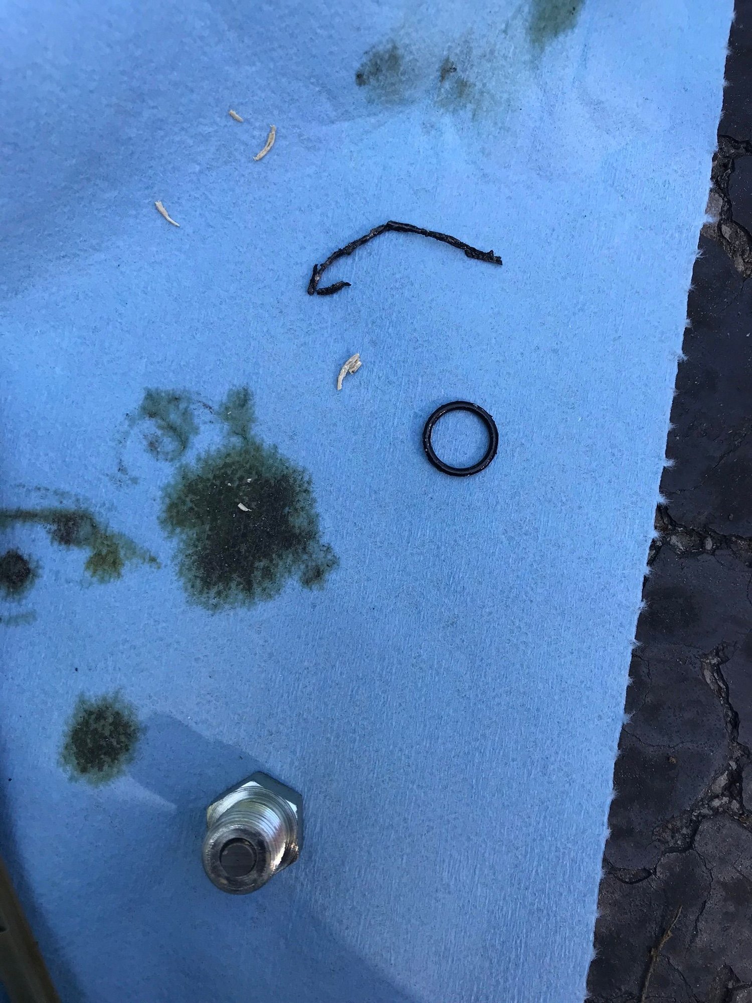

Well looks like someone was trying to keep this from leaking 😂

That`s thread sealant, the factory uses it for some reason.
It seems like a lot of people on the forums think it is needed because it was originally on there.
Just clean it off and make sure the o ring is in good condition.
Just noticed the double o ring, jeez....
I`m surprized it wasn`t leaking with 2 o rings on the plug.

Yes I cleaned it thoroughly and used new viton o ring. So far so good. The second o ring doesn’t look like it was viton. 🙄
