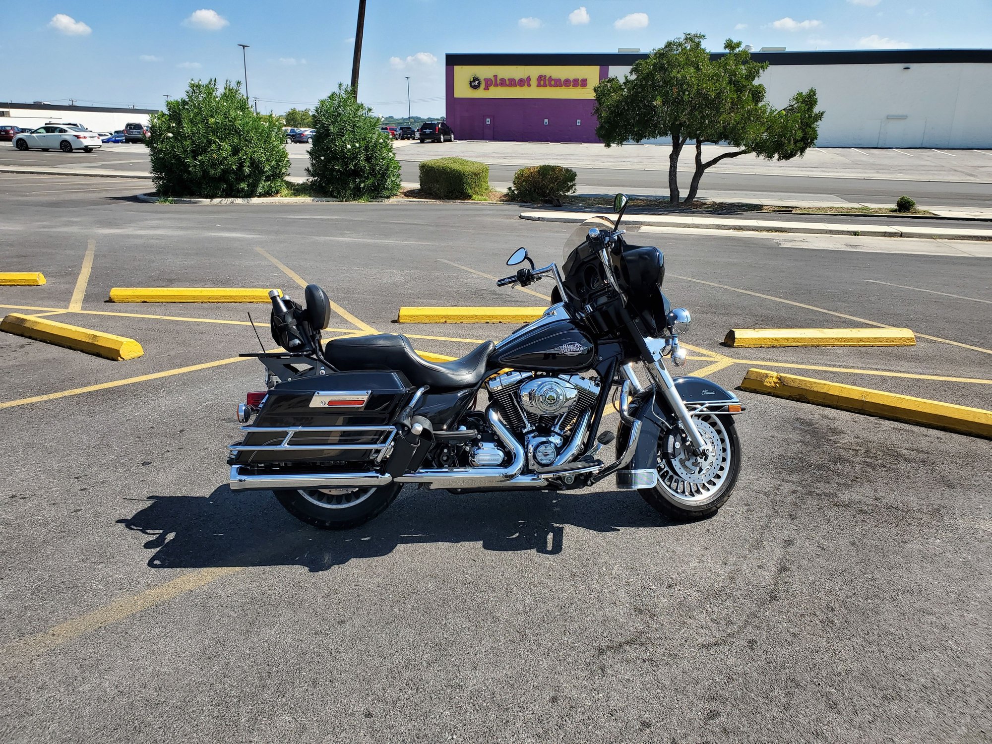

I got a FLHTC 20012 with a stock 103 on it... I have changed the header pipe out to after market pipe. No cystic ( Sp)converter . ..Night-stick mufflers..( still a 2into1 back into 2 exhaust). Put on the high flow intake air cleaner. And dynod the bike. . Dyno reads it turning 80hp. .. that's the back ground of where I'm at now..
. Here's the question... I'm happy with the Acceleration of the bike off the line up to say about 60 mph. But I want more power in 6 gear. . (More acceleration ) . I dont want to lose any of my top end speed. . But the bike needs more punch in its 6 gear. My old lady usually rides with me. So I know her weight slows the bike down...
... any suggestions on a good set of cams to buy for my bike...??
or an engine kit ?
