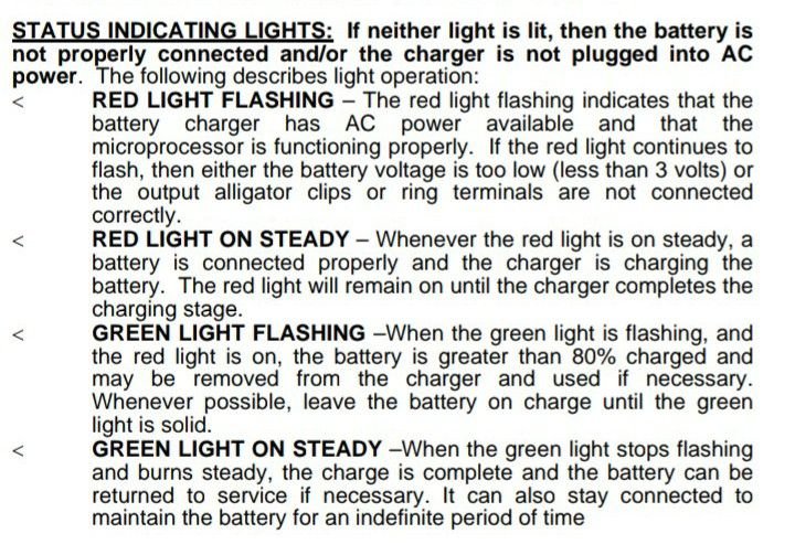

Bought a tender plus. Put it on. Light will only flash, which according to the manual means the battery is defective. The voltmeter on the bike says it's at about a 9. I was hoping to avoid taking the seat off and getting into the battery. I have a bigger charger - but obviously can't hook it up without a little disassembly.

According to Battery Tender, the Battery Tender Plus is a charger and float charger...
Once battery is fully charged, it switches to float charger mode. Why muck around with two pieces of equipment when one will do the job (I already have way too much stuff in my garage ).

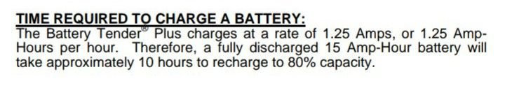

Which light is flashing, red or green?
If the green light is flashing, you may need to give it more time.

You are going to have to pull the seat and check the termi Al's to ensure that someone didn't swap them when replacing the battery. Personally I have 2 battery tenders (1 for LiPo and AGM batteries and 1 BT+) I also have a Harley LiPo charger and an Optimate 4 charger. All 4 of them work well, the Optimate will bring a battery back from the dead.
