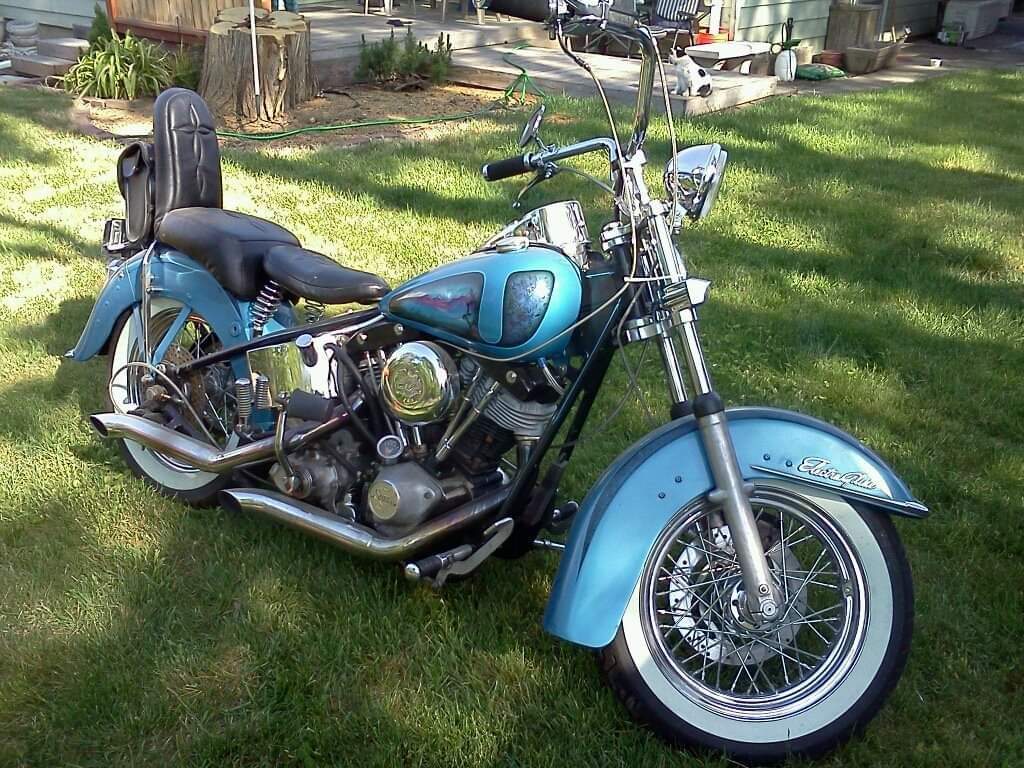

From: Idaho
This is the only one I got at the moment, it’s in my shop just dusty needing a bath

These guys will get you going. Sorry about your dad and brother, this is very sentimental i am sure. It should be running in no time with a little bit of elbow grease and money.
You might want to post this in the Shovel section of the forum. They will know this bike top to bottom

Sweet looking bike! Be sure to post up in the shovelhead subforum in the classic section on here for answers as well.

Nice ride, enjoy learning your way thru it. Will pick myself up one of these some day, I;m envious.
