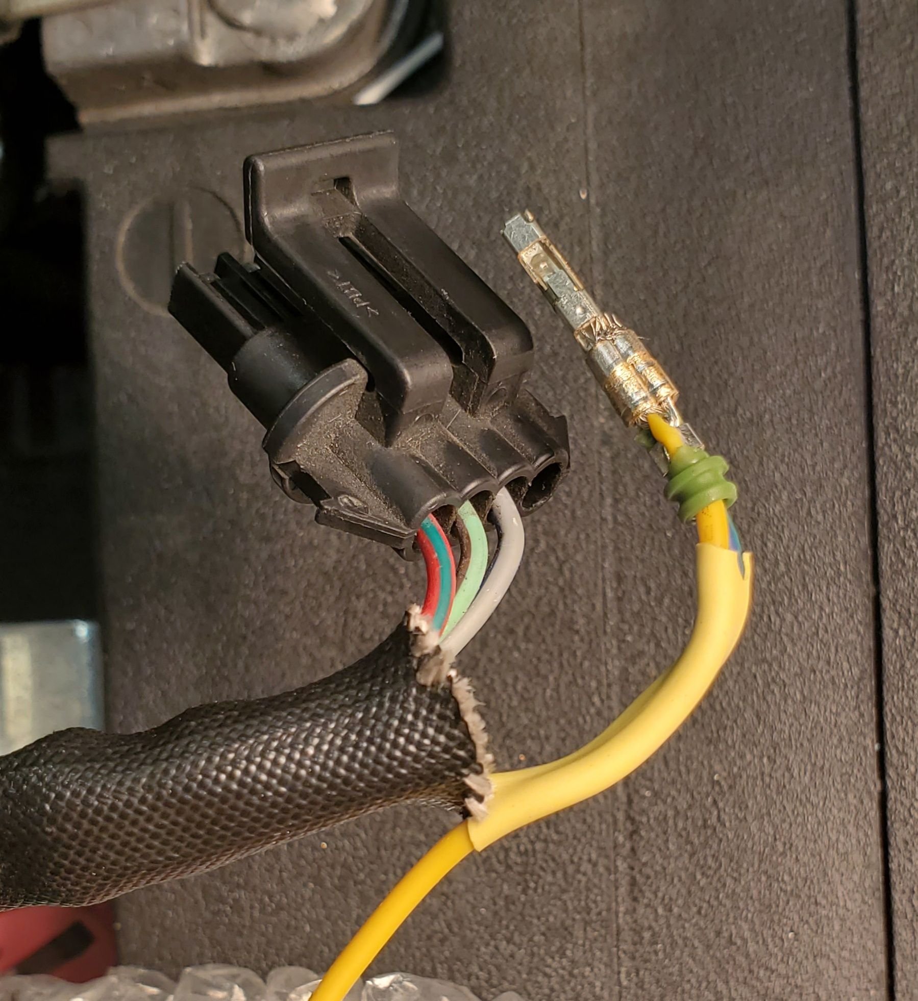

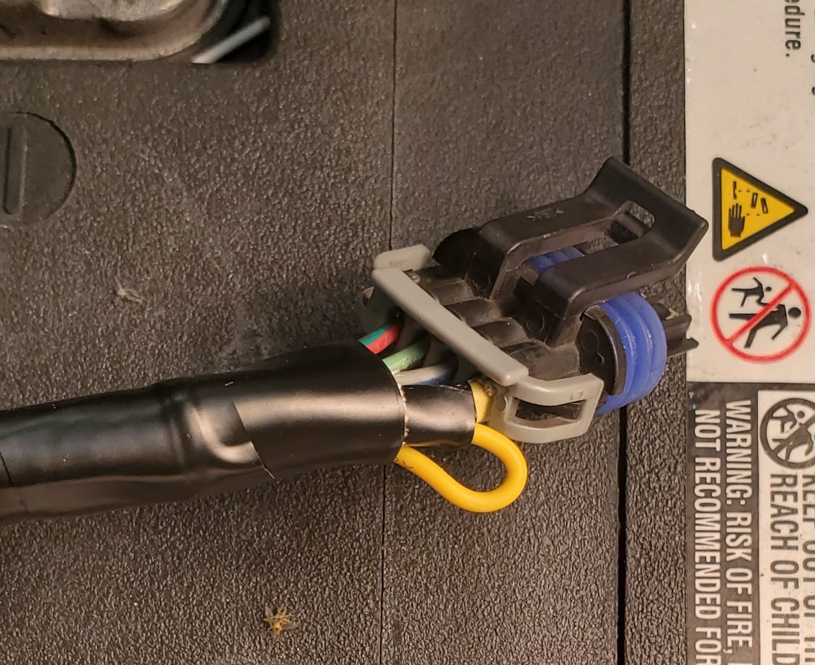

Hello SCDLCA....... It works! I connected the tach trigger wire to the #1 cylinder negative coil terminal in the coil connector, set the tach to .5 PPR, and Voila!
It took me 3 hours to make a connection to the coil wire. I made a crimp connector and attached the new pigtail to the top of the existing terminal crimp.
New pigtail wire crimped on.
Finished Connector, ready to plug back in.
