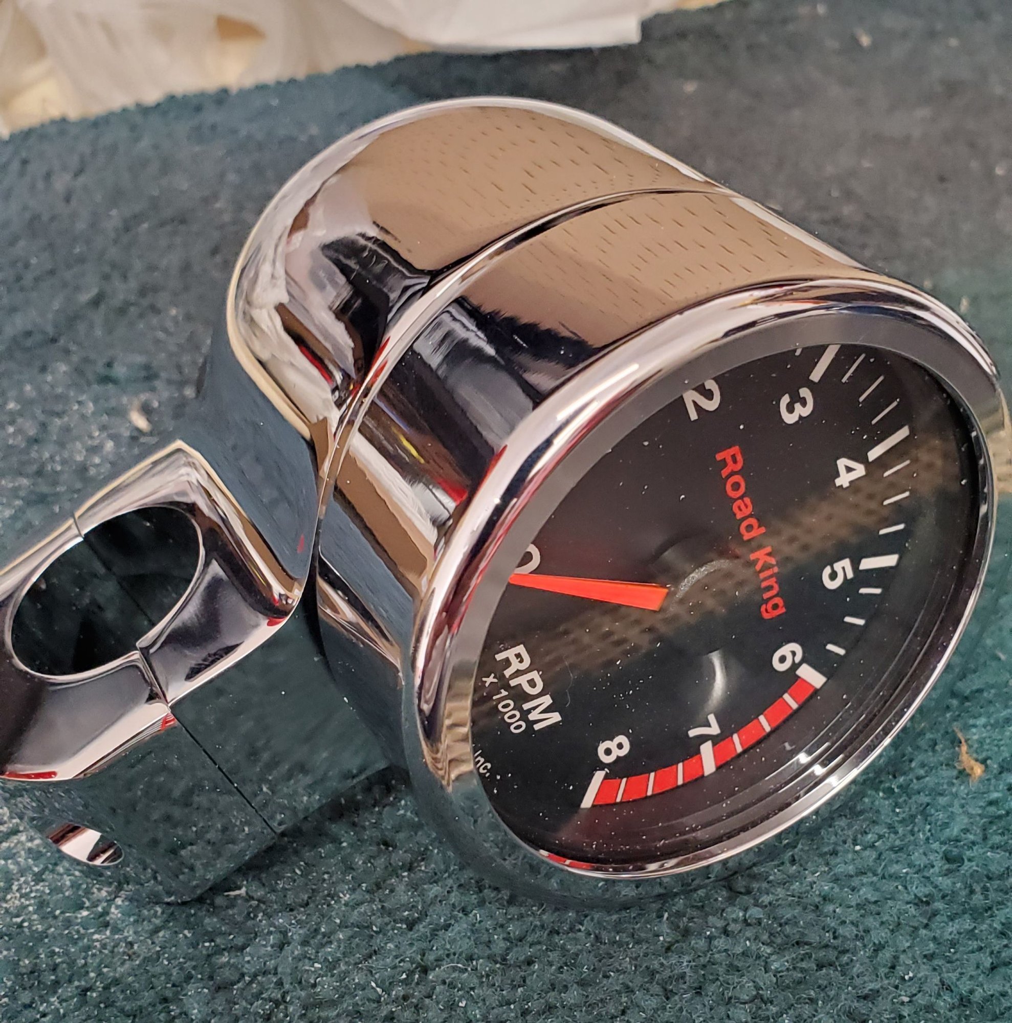

I ordered a Speed Hut 3" tach to my liking. Attached a wire to the front cylinder coil negative side inside the connector (not easy!). Set the tach for .5 pulse per rev per included instructions, and it works... I bought a Baron chrome housing and had to make the tach fit inside it. Hand filed (3 hrs!) to remove the threads that secure the original tach bezel to the tach body, as well as filed down the diameter of the lens. Now tach and lens fits inside Baron housing. Next I gotta mount on bars and wire to bike.

Very cool solution. Here are some others.
https://www.hdforums.com/forum/milwa...king-tach.html
Here is how I did it..
https://www.hdforums.com/forum/milwa...l#post17274765
