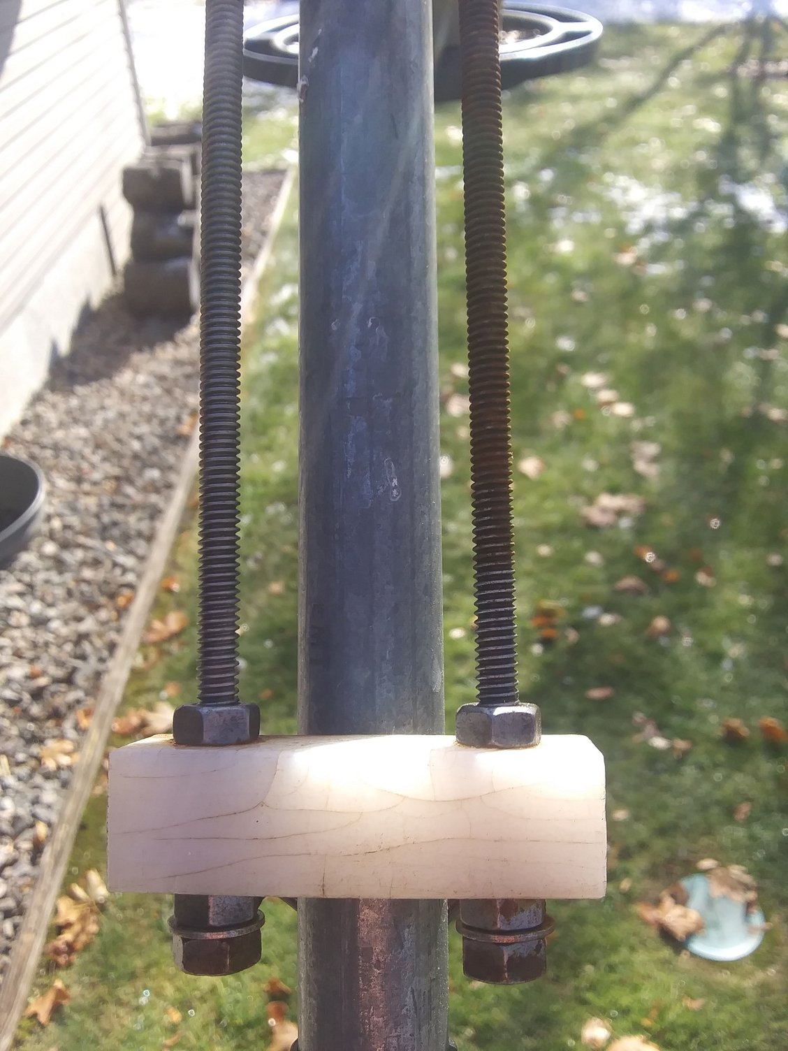

These two sections of threaded rod are exposed to the elements 24/7. About two months ago, when they were both rust free, I treated the left rod with 3-IN-ONE oil. Ran out of 3-IN-ONE, so I treated the right rod with WD-40.
I'm not knocking WD-40, it's a great product, however It's obvious to me other products are better suited for rust prevention.

Wow............interesting. THAT is a HUGE diff. But is that metal the same as the screws/bolts used on a HD? I think not. BUT still. I copy/pasted that and sent it to my friend. TY..........
Both threaded rods are grade 5, originally zinc coated to prevent rust, but eventually rusted from years of exposure to the elements. Wire wheeled both to bare metal before the two different treatments.
Using an ill fitting torx driver on a new HD screw may also remove a bit of its original coating, and expose some bare metal, which would be prone to rusting if left untreated. Even the best torx drivers wear out after repeated use.
