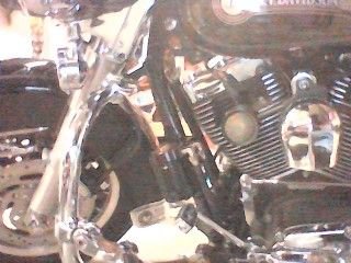

No more mess
The only thing I use that orange thing for is to get break fluid into a hard to reach rear master cylinder ( think dyna)
Last edited by Low budget Dan; Nov 1, 2020 at 01:03 PM. Reason: Forgot the picture
