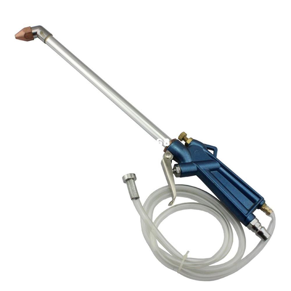

Just thought I'd throw this one out there . I have one of these , cheap and works very well . If you have an air compressor , this will make cleaning that area a breeze , I use an antifreeze jug to hold water , I drilled a hole big enough to push the hose through and added a smaller hole so it could breath . After you get it completely clean , unplug any electrical connectors and spray them down with electrical contact cleaner . Your Harbour Freight should carry this .
I use dawn dish soap mixed with warm water to clean oil and gunk , works very well .
